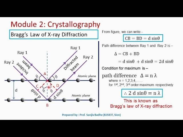

Bragg's law is schematically shown on the picture:
Diagram of Bragg's law of X-ray diffraction: two parallel incident rays reflect off two atomic planes spaced d apart, with path difference 2d sinθ = nλ shown beside it.
Two parallel and plane waves are shown which propagate towards the crystal. For plane waves, wave fronts are flat planes perpendicular to the wave propagation with infinite size. In reality, there are no plane waves. Nevertheless, they are used as they are often a good approximation.
I have two questions:
1) How do we know that the interference of two waves hadn't happened before both waves interacted with the lattice? To be more precise, waves shouldn't interfere before the left ray reaches point D as we want that the left ray travels that extra distance (from C to D) to see what kind of interference result we get. Wave fronts of real waves extend in space as wave propagates and so interference may happen before both waves interacted with the lattice (before left wave reached point D) . If that happens, there is no much use in the Bragg's law.
2) Bragg's law is based on the interference of two parallel waves. Scattering of the x-rays happens because electrons absorb x-rays and re-emit them, but they do so randomly, in all directions. Constructive interference can happen if waves of different propagation directions interfere and so, if we see the bright or dark spot of the interference, how can we know that in fact two parallel waves actually interfered to give that spot?

No. There is only one incident plane wave. The diagram shows two rays for a single incident plane wave.
The diagram (which is commonly used) is misleading IMO.
The upper atomic plane scatters some X-rays in random directions. We consider only the scattered radiation in the direction given by θ. In effect, some of the scattered radiation behaves the same as a 'reflected plane wave' leaving the upper atomic plane at angle θ. (Only one ray from this wave is shown on the diagram.)
Some of the incident radiation reaches the lower atomic plane. The lower atomic plane scatters X-rays. Some of this scattered radiation behaves like a 'reflected plane wave' leaving the lower atomic plane at angle θ. (Only one ray from this wave is shown on the diagram.)
The interference is between the two reflected waves - the reflected wave from the upper atomic plane and the reflected wave from the lower atomic lane.

It is of crucial importance that these waves are parallel before and after interaction with the crystal as only in that case Bragg's formula has sense.
The Bragg diffraction is like the Fraunhofer=it is for the far field, and where the path distance difference between two rays coming from adjacent planes (they can be assumed parallel when viewed in the far field) is an integer number of wavelengths.
The Bragg diffraction has the additional condition that the angle of incidence onto the plane(s) is equal to the angle of reflection. This makes it so that the rays from atoms in the same plane have zero path distance difference between them, and thereby also constructively interfere.
Thereby, with the Bragg condition, the rays from all of the atoms in the crystal constructively interfere, (as viewed in the far field). Note: If the crystal is small, the far field can be just a meter or so away. You can also create far field conditions by observing the pattern with a lens, with detector or paper in the focal plane of the lens, even for very short distances. (This "trick" is used in diffraction grating spectrometers, where with a 2" size diffraction grating, the far field would otherwise be a couple hundred meters away).

Yes, you are correct about the rays and waves. We have one incident wave and two rays we consider. After scattering, two waves will be created which then interfere.
If scattering happens in random directions, how can we only consider one direction? EM waves from different directions can also interfere which will affect the diffraction pattern.

Hi @Dario56. Given the other posts, you might have resolved this by now But, in case not, and since you specifically asked about what I said, can I add this...
‘Random’ is a bit misleading. There is a well defined angular distribution of intensity (Thomson scattering).
We consider all directions. It turns out that destructive interference will occur in most directions. But in one (or a few) specific direction(s), constructive interference will occur.
