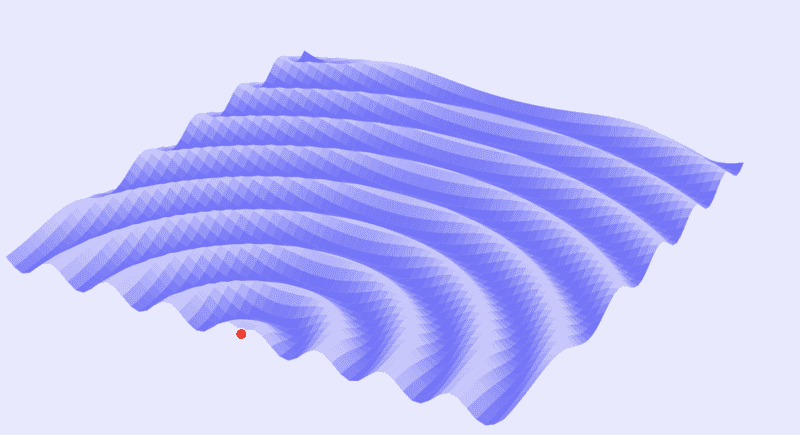

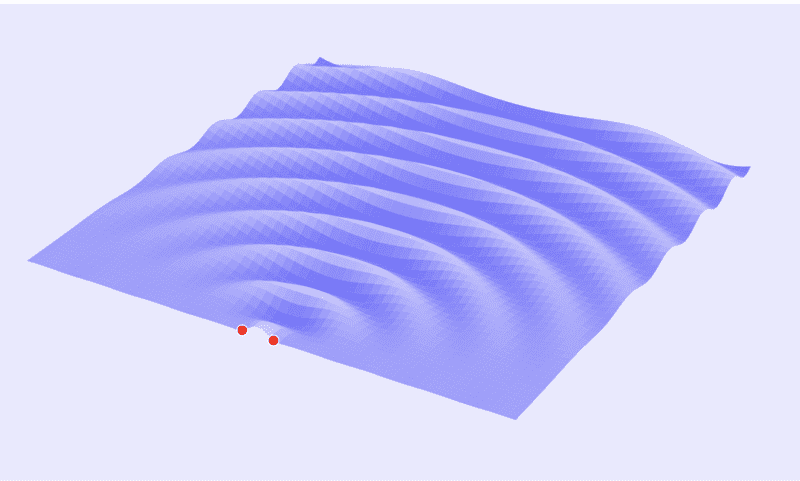

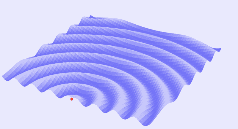

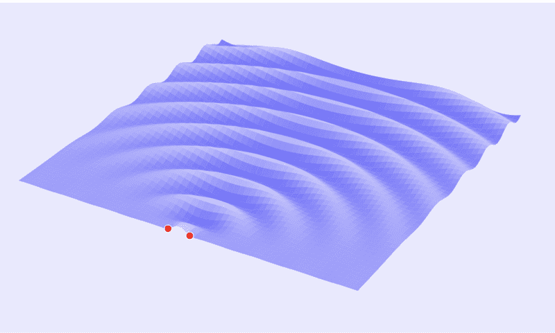

  • #37
Hello Martin!
Many of the answers say that the conservation of energy is maintained because energy is 'redistributed' or goes to other location of constructive interference. This is an explanation which only roughly fits in certain cases but fails in some other.
The real explanation is not as straightforward as it seems. Although the energy of the whole system (source + receiver medium) is conserved, the energy radiated to the medium is not always the same or conserved!
In the case of YDSE or Young’s Double Slit Experiment, we observe that the average intensity of the fringes to be 2 times the Intensity of a single source. So far so good, then where’s the problem?
Now consider the following situations. Consider 2 sources are radiating waves of same frequency, same amplitude and no phase difference. :-
  1. In case 1, the distance between these sources is λ/2, as shown in Figure 1.
  2. then it is reduced to 0 in Figure 2.
  3. If we calculate the power dissipated in these 2 cases, it turns out to be equal to 2*P in case of Figure 1, and 4*P in case of Figure 2. This clearly shows that by changing the distance, the net energy dissipated in medium is changing, not conserved.
    We can qualitatively see this in Figure 1 and Figure 2. In Figure 1, The waves are absent in the sides, and in Figure 2, waves are present everywhere. This gives us the clear idea that more energy is being spent in case of Figure 2 The question is how?

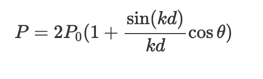

***That is only possible if the two sources are in exactly the same place. There will always be regions where two real sources are in anti phase. So there's no need to worry that Physics got this wrong.***
- not necessarily. Consider 2 sources in phase with a distance, say λ/8. In this condition, the combined energy dissipation is still greater than the sum of individual power dissipation for isolated sources. The formula which represents all cases is (formula is given by Vanderkooy and Lipshitz in their paper Power response of loudspeakers with noncoincident drivers – The influence of crossover design) :-
Where,
  1. P is total power radiated by both sources
  2. P0 is the power radiated by single source in absence of other source
  3. k=2π/λ, λ is wavelength of source
  4. d is the distance between 2 sources
  5. θ is the phase difference between 2 sources
If you plot graph for this particular equation, it looks like following for a phase difference of 0:-
So for any distance lesser than λ/2, power dissipation will be greater than 2P_0.

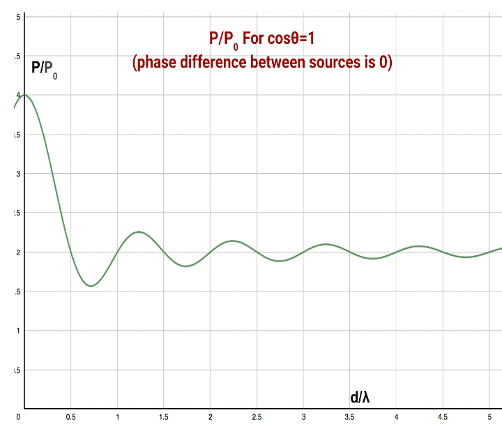

Yes, there is no sudden discontinuity in the power radiation as the distance between sources decreases.
Where,
you can see for larger distances(d>>λ), it is converging to 2P_0, and this is where the 'energy redistribution' argument roughly fits. Why rough? because you can see the graph still oscillating, but with minimum amplitude.
Im not sure if external links will be allowed by moderators but if they allow:- https://hackmd.io/@sharada10/wave_interference_energy_conservation

  • #51
sophiecentaur said:
The problem with this is that the Power in the wave depends on the impedance as well as the E field. P0 is only P/2 when the sources are far enough apart to ignore interactions. This expression:
doesn't include the impedances involved - there's more to it than just the spacing. Both E and H fields count and also the source impedance, self Impedances of the antennae and also the mutual impedance. So that expression 'just' a system that may produce the right answers under some circumstances.
I'd be very suspicious of any work that suggests non-conservation of Energy. In the case of radiating systems, calculations are always of limited accuracy and they always require numerical solutions so I'd suggest that there will be a flaw that remains to be found.
1. There is absolutely no violation of the conservation of energy. The only difference is the consideration of work done which is usually ignored.
2. The expression doesn't contain the terms of wave impedances, but the impedance is already taken care of in the equation.
For example, a source will experience the highest impedance when it experiences a wave of the same amplitude, frequency and phase, which also means when the 2 sources are put at the same point. Now the power radiated in this case is 4P_0 by both sources, so this already includes the additional power dissipation by the source to overcome the resistance. You can see the same with destructive interference and other interferences in between.
3. This formula hasn't considered parameters like heating effects or others.
