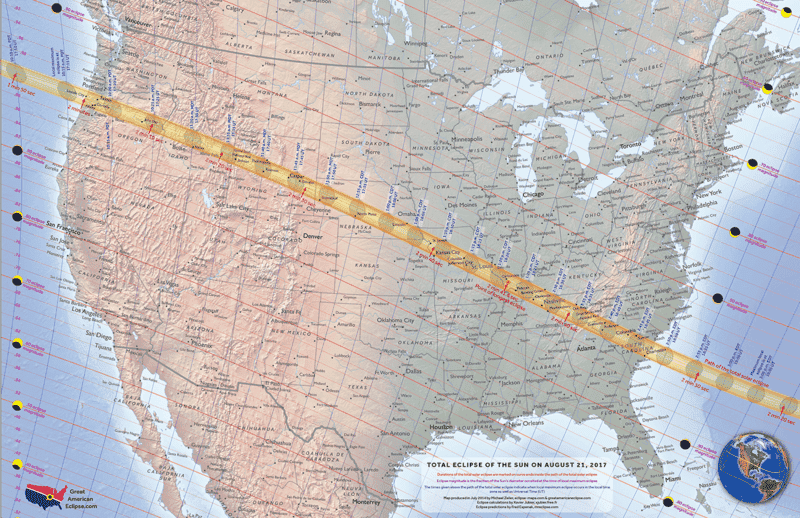

I observed the eclipse from Washington DC area yesterday. I have a few questions.
from the eclipse map and youtube clips ppl uploaded, the eclipse starts in Oregon and sweep across states.
questions:
1. I know Earth rotate around itself from west towards east every 24 hrs, is this the main reason ppl on the west coast see the eclipse first?
2. which direction moon rotate around earth? I assume also west towards east?
3. it took around 1 hour and half for the totality max region sweep through continental US. 1720UTC ~ 1845UTC. is this mainly corresponding to Earth's rotational speed or moon's?

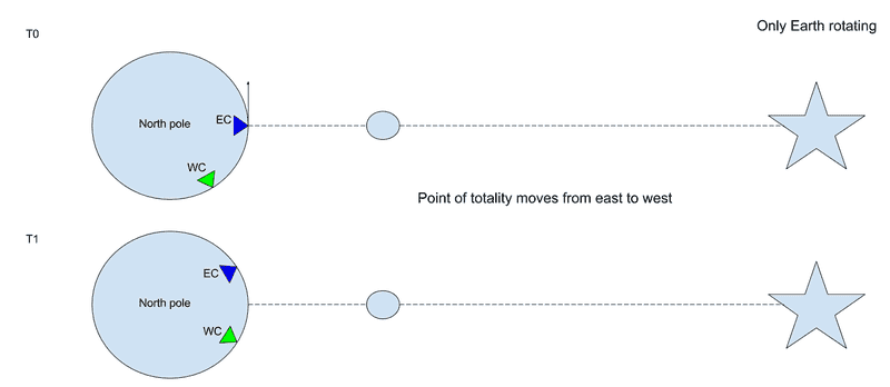

First case:
The Earth and the Moon are stationary both w/r to each other and w/r to the Sun. The Moon casts a permanent shadow along the dashed line to the left. As the Earth rotates under it between initial time T0 and some later time T1, the shadow moves from East Coast (EC) towards the West Coast (WC).
(the magnitude of this effect is easy to estimate, as it's always 15 degrees longitude per hour, regardless of latitude)

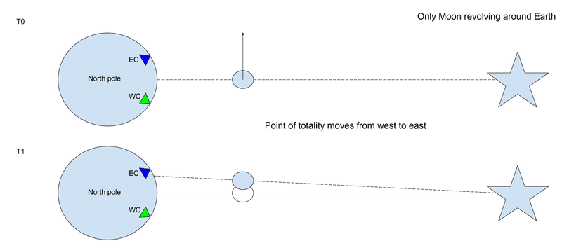

Second case:
The Earth and Moon are not revolving around the Sun, nor is the Earth rotating. The Moon is revolving around Earth. As the Moon moves anticlockwise in its orbit, the shadow cast along the dashed line is sweeping eastwards across Earth's surface.

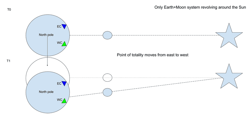

Third case:
The Moon does not orbit the Earth, and the Earth does not rotate. The Earth and Moon system moves as a whole in its orbit around the Sun. The shadow of the Moon sweeps westwards across the Earth's surface.
