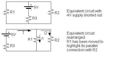

The 4V battery calculation looks fine. The 6V calculation needs a re-think. Try redrawing the circuit when the 4V battery is removed, moving R1 to the left vertical position (where the 4V battery was) and R2 to the right vertical position (ignore the ground indicator at b for now). What's in parallel?
Oh right, everything is!
Okay, Req=[(1/4)+(1/5)+(1/3)]^-1=1.277-olm
Is=6V/1.277=4.7 A
now, through the 4 olm resistor we have:
I=(1.277/4)(4.7)=1.5? Thats weird
Well, you have three parallel branches anyways. One branch contains the series connection of R3 and the 6V battery. But I think you can see how R1 and R2 are in parallel, and you can work from there. Either find the voltage across the R1||R2 pair and then the current through R1, or find the total current provided by the 6V battery through the equivalent resistance and then current-divide it through the R1||R2 pair. Your choice.

Here's a couple of diagrams that might help to visualize what we've been trying to accomplish with the 6V battery contribution.
