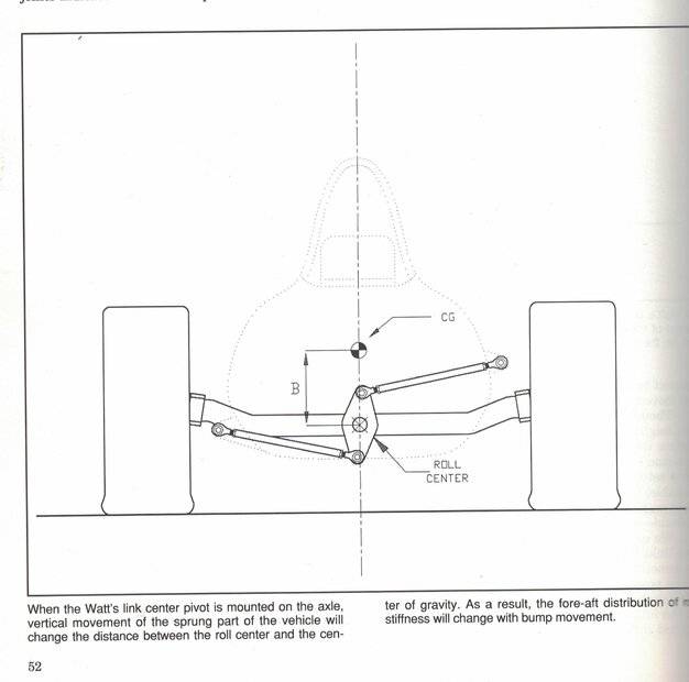

Mike,
What are your thoughts on the typical dirt modified/dirt late model 4-link suspension? Specifically, the left rear suspension?
Everyone is using a suspension droop limiter (chain or underslung bar). This seems silly to me. Could we use the left rear droop limiter to add load back to the tire? With a type of cantilever that turns the pulling motion on the limiter chain into a pushing motion on the rear coilover?

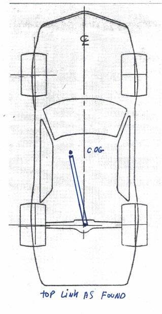

Thanks for responding Ranger Mike, My traction problems are when the throttle is first picked up in center of corner, if I let it roll past center and the car is straight I'm able to mat it quicker. It's not loose on exit of straight away.
I'm running 3/4 stagger on front and around 1 /3/4 on the rear.

My third link was centered and I've moved it to the left Its now set at 34" from the right.

in my opinion, the 4 link dirt track suspension is the only way to race dirt. It is specifically designed to tune in and hook up on a dirt track. It is tunable as the track changes during the night. The 4 link is made to use the car’s body ROLL to jack in Roll Over steer. When you add a chain to act a droop limiter you just made a really big Go Kart. But...
Todays racing shocks ( dampers) should never be used as a suspension travel limiter. You can use a chain on left and right rear to limit travel just under the maximum extension of the shock so you don’t pull it apart . A hard stop or cable is better as chains do stretch over time. This is the only use of the chain I recommend on a race car and is not to be used to tune tha car. Set it up to save the shocks and don’t use it to adjust.
Think about the sequence of events. You fly into the turn, throw the car sideways and steer with your big toe. Looking at it frame by frame, Forward momentum is still going forward as the tires plant and counter this force. The Body is still traveling straight until the tires stick and the body now rolls thru the roll centers to down load the right side tires. We have jacking effect and the right front, right rear compresses as the left front lifts and left rear goes to droop. Then BANG, the chassis/rear end hits the chain limit and you SNAP load the right rear tire to to the point you loose traction. Now you are loose and back on the gas working the turn to exit. To the driver it feels like the chassis is really working but you just made the car a giant go kart for a brief amount of time. It works but not the fastest way around the track. What is really happening is the 4 Link is making traction as it is designed to do and the car is set up too tight. The Snap Load is a way to make the car turn.
I when thru a mechanical droop limited period in the Formula car days before I found a fellow who rebuilt shocks for Indy cars and taught me a thing or two about racing. Joe is dead now but he was the best. My advise is to forget the chain AS A MEANS OF TUNING and tune in the chassis with the shocks (dampers ). Think about retaining Momentum and back of of thinking Traction thru the turns.
I do not race dirt so I am the least knowledgeable on this matter but I recommend you read these links by dirt track racers and try their suggestions.

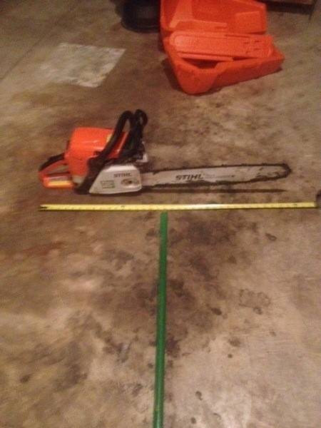

Orange and white STIHL chainsaw lying on a concrete floor beside a yellow tape measure laid across the floor, with a green pole running vertically, and an orange plastic carrying case in the background.

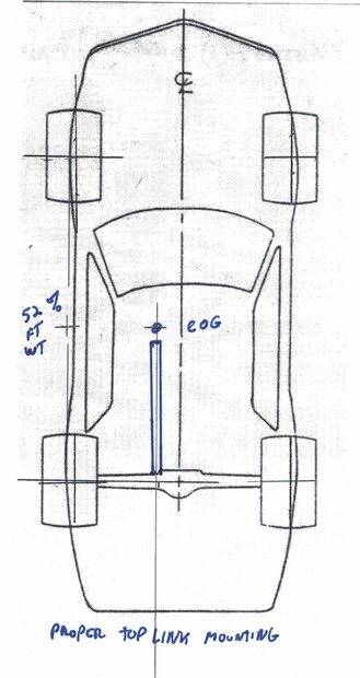

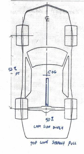

One thing that sticks out is the top link mounting location. Top link should be mounted at center of weight mass of the car. In your case you have 56.1% left side weight. Your rear track width is 63.75” so 63.75 x 56.1% = 35.76” location from right tire centerline. You had it placed at the center or 31.87” from right tire centerline. No wonder the car was having problems rolling on the throttle.
Think of your old chain saw you laid on the shop floor. The Chain saw is 36 inch long so the center line is 18”. Now take that old green broom handle you use to beat the neighbors dog with and place it at the 18” mark. (see photo). Try pushing the chain saw forward. Now move it to the left and place it closer to the center of Mass and push it. Things move a little more equal..right?
In the case of the top link you are pulling on it and not pushing but you get the idea. This is why we have to use available force , mechanically to our best advantage so now you know why the top link mount is so important.
How much travel is the top link spring compression? Should be 1/2 inch which is ideal?
I would add a top link damper ( shock absorber) mounted 5 degrees up hill. This will assist tuning. Range on mounting up hill is 0 to 7 degrees. Mare angle tightens chassis on corner entry less loosens on entry. Never mount it with down hill angle.

I have it all the way to the left against to bracket on the left side so I can't quite get it to 56%. I moved the front mount to the left the same amount so it won't be pulling in a angle. I assume this is the proper way? Pull bar spring is preloaded a 1/4" and it's traveling close to a 1/2"
If I put a damper shock on should it be like a 90/10 or what would your recommendation be?
I also wanted you to see my tire temps after practice before I moved the link. I normally have a 30° degree split in Rf so I made a minor camber adjustment to bring inside Temps down.
Longacre 12 Temp Memory Tire Pyrometer display showing two rows of six readings: 150 142 142 156 149 127 and 148 152 153 165 161 155 (last value partly obscured).
you have the top link mounted for 53% left side mass. I never was satisfied until it was right but racers are weird like that. the shock is to keep wheel hop away when braking. A 600# compression and 65# rebound is typical for the 3rd link damper. Before you change rt ft camber check your toe - out as the readings are typical for wrong toe out condition.

Mike, I went ahead and moved my top link bracket further to the left so now the pull bar is at 35.75 and I have it exactly 90° to the chassis. I thought about the toe out you mentioned and I know my bump steer was .33 at 3" so I decided to check my Ackerman and I had 3° more in the left so with it being a flat sweeping corner I'm going to take it out and see if that lowers the inside temp on the RF. I have checked camber gain as well and it's only 1° at 3"of travel. The Hoosier tire has always seem to cut better with a hotter spread than you mentioned but I'm ready to try it and see. I worked real hard to get all 4 tires with a full contact patch and the car slowed drastically so without testing it more I went back to my old set up. Thanks for taking time with me this week and If you happen to think of anything else please let me know. I will be racing it this weekend and will give you a report on how the changes affected it. Thanks again.

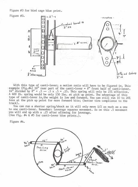

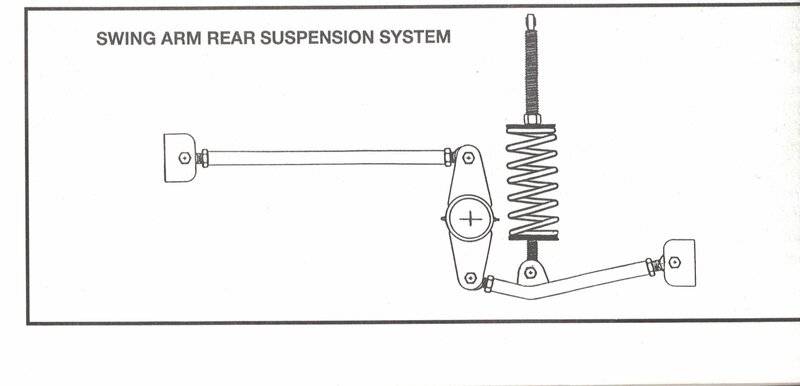

What are your thoughts on this new style top link or 3rd link, or lift/pull arm... I work on template late models of cra, southern super series straight rail aphsalt cars
  • Diagram of a rear axle housing with a red centre hub, showing a yellow-gold adjustable link arm attached to a triangular bracket on top, with a ball joint at its far end; a red arrow points to the hub and a black X marks the bracket.
  • Side view of a race car suspension component: a round rotary damper unit with a red center cap mounted on a grey American Made Ridetime arm, linked by a rod to a bar on the right, with red arrows and a green check mark marking the mounting points.
In the Northeast this is referred to as a Torque arm. They have been used on primarily on asphalt modifieds. I have seen them mounted to both the left and right sides of the rear ends and used successfully. You show a solid link at the front, many guys around here use a rubber biscuit and control the amount of bite" by how much play is in the biscuit.
I know when I look at it, I see a three link suspension with different mounting point. I would be curious to hear what others opinions and experiences are with this setup is as well.

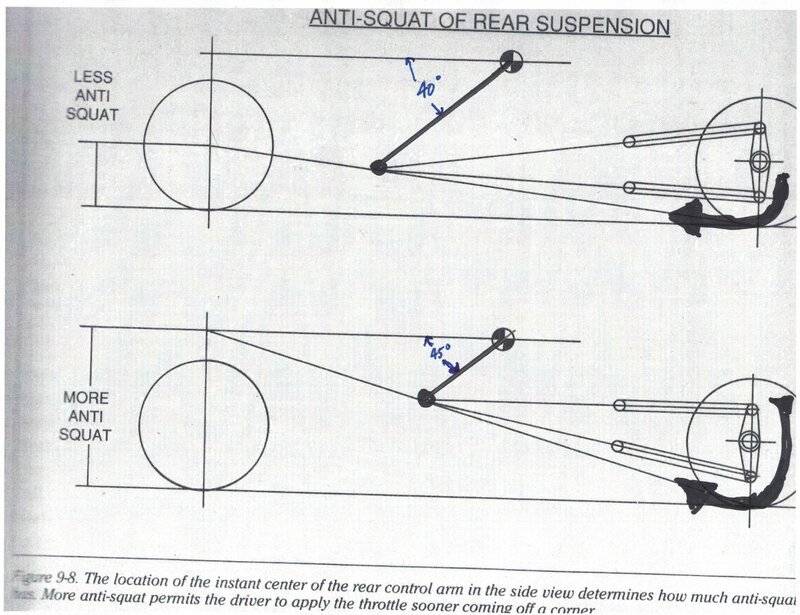

Lets review the old 3 link and what's happening.
The 3 Link set up has evolved from the old truck rear end set up with long training arms and two upper links. The 4 link evolved as well and took off in the dirt track world with the bird cage and many tuning variations. This long Traction Arm is a variation for the 3 Link set up. The geometry of the 3 link linkages are such that Acceleration caused by the engine translates into rotational force via the differential. We have Tires contacting the track in one direction, axle wrap in the opposite direction.
Various linkages ( 3 or 4 link) react to the forces by lifting and pushing. It just so happens that if we draw a line from these links to the front of the car we construct an Instant Center (IC)where they meet. From this IC we have a Torque Arm ( lever) and this all results in the application of force during acceleration. This force will compress the springs and cause Anti-squat.
Anti-squat causes the rear end housing to apply more force to the chassis and down loads the tire for more traction. We get 100% anti squat and we do a wheelie! Not good in round track racing!
The longer the Instant Center the less the IC will move around during rear chassis roll, wheel and suspension links moving up and down and will provide the driver with a more stable feeling under acceleration. I think we ran a pull bar from the traditional mount on the Quick Change all the way to the transmission chassis hoop one time.
The whole point of this is try to maximize the control of the rear ends rotational torque for optimum tuning. The big draw back to anti-squat is that it will have an equal and opposite reaction under Braking. You could suffer wheel hop and a light rear end under braking conditions.
Bottom line is – Any time you can have an Instant Center closer to the front of the race car, it will have less movement during chassis roll. You will have a longer lever to counter rear end axlel wrap. This will make for a more stable car under acceleration and braking.
One note for the readers who are trying to understand the forces we are dealing with. Think Drag Racing.
Anyone who was around in the 1960s ( I was) will remember the Detroit Iron Muscle cars were the rage and just about every Camaro and Mustang had traction bars sticking out in from of the rear tires. No one bothered to tune them but the looked mean as help and did manage to hook up half way good. Of course the Chrysler boys engineered the proper set up and had a pinion snubber working with Hemi leaf springs but that is another matter.
There are three points to ponder here. Traction Bars use rear end rotation to slap the traction bar to the chassis and hook up the tires under acceleration. The Suspension links still formed an IC. Traction bars were mounted only at one end. Again, Anti-squat causes the rear end housing to apply more force to the chassis and down load the tires for more traction. We get 100% anti squat and we do a wheelie! Not good in round track racing!

Ref- torque arm mounting – as I posted a few posts back- try to push that chainsaw with that broom handle at a location other than center of mass.
As you stated correctly, for best results the 3rd link or torque arm should be mounted at same % as left side weight. I know the practical side of things mean you mount it as best as you can but try to hit a happy balance . You have to decide if the % of races you have won is because of out accelerating the other guy or out braking?
That will ultimately determine the locations.
There is some fuzzy thinking on the mounting location for the top link. When looking to the front from the rear end of the car, the engine torque twists counter clockwise. The thinking was that this loaded the left side more than the right side. Since the left was loaded more the car would shoot toward the right side because of this twisting motion. So this ideas was to mount the third link more toward the passenger side or right side to counter this. Maybe in drag racing but not on a round track.
Looking at this in detail as torque is applied from the driveshaft to the rear axle, multiple forces begin to leverage the car. Engine torque multiplied by the transmission gear ratio and axle ratio generate a few thousand ft. lbs. of twisting motion. The first thing the pinion gear tries to do is climb the ring gear. This forces the nose of the rear axle upward. As the car begins to accelerate, the torque wants to lift the front of the carupward, causing more down force on the the rear tires. As viewed from the rear of the car, engine torque twists the body clockwise, lifting the left front and compressing the right rear spring. As the pinion continues to apply this massive torque through the ring gear, the rear axle housing is also being leveraged in a counterclockwise direction lifting the right side of the axle and planting the left. As the car accelerates, it appears to be planting the right rear tire but is really unloading the tire, thus reducing traction. Torque over steer.
You can still see this dramatic body twist at the drag strip. You have very sticky drag slicks ( not hard spec tires that you have to use) you have 50-50 left to rt side weight % and up to 100% anti squat. All the linkages are set up to do one thing, provide maximum down force to the rear tires under acceleration. The body is really twisted under axel wrap. Because this car was originally designed to be a family grocery getter, the suspension was made to give the softest ride with best the best handling and comfort. The 4 link rear suspension gave good traction in rain and snow. When it grew into a romping stomping muscle car with a 396 cubic inch engine, spring rates were upped and heavy duty shocks were added as were bigger tires. The design was still based on the comfortable balanced 4 link package. No wonder the darn thing wants to climb to one side and fish tail out of the gate!
The classic 3 link suspension negates a lot of this simply by the fact that you have only one top link. Where it is mounted and the angle it is mounted relative to the rear end is critical. If the link is not mounted at the center of weight of mass of the car the tire loading will not be equal when accelerating. It is that simple. On a locked rear end you need to load both rear tires equally.
Power torque over steer is negated by cross weight or wedge. When you put that greasy 1/2 socket on the floor jack and jack up the rear end, the right rear tire moves about 3 inch off the floor before the left rear does. Wedge or cross weight.
You use this static set up to counter the force of inertia created when entering a turn. It is a must for you to properly apply power equally on the rear tires on turn exit.
When you bomb into turn one, think of three vectors or force arrows. 1. from the rear to the front. 2. from the left to the right. 3. from the left rear tire to the right front tire. These three vectors are the momentum forces at work. The entire spring / ARB/ shock package and the tires are for countering these forces. You have good phase one and phase two handling and now want to exit.
You ROLL on the gas and power torque over steer putting down force on the left rear tire. This is some what canceled out because the whole chassis was trying to lift the left rear tire due to that diagonal force vector #3. You are still in the middle of the turn and the right side springs are still compressed some what. If your top link is mounted correctly and at the proper angle you will be putting some down force on the rear tires ( commonly know as weight transfer) by lifting the chassis through the linkages. If you have the right cross weight you should have equal traction as tire temperatures will tell you.

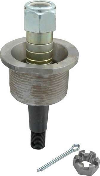

If you are limited to stock A-arms, and you are permitted to replace ball joints, you can grind the Ball joint hole oblong to offset the ball joint by up to 3/8” to the inside on lower left side or outside on lower right side. and weld in Screw in ball joints like Chryslers. These will stick the spindle up about 3/4 “ higher from bottom A-Arm and move the upper A-Arm 3/4” higher for even more angle. Afco, U-B Machine , Speedway Motors, Coleman racing, have these. Check our Colman racing. Adjustable upper ball joints.
http://www.colemanracing.com/Integral-Ball-Joints-for-Lower-Control-Arms-P6201.aspx
http://www.colemanracing.com/Ball-Joint-Mono-Ball-Upper-GM-18-Degree-P3688.aspx
Don’t forget. You can move the A-arm inner mounts as well so there should be enough wiggle room to get the roll center close to the proper height and offset.
