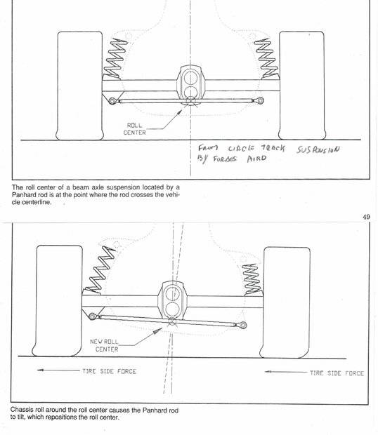

Panhard bar
Do not forget- The mid point between the right and left side anchor points on both panhard bar and J bar is the Roll Center. This Rear RC can be offset many inches from the vehicle centerline.
When Panhard bar has chassis mount on frame right side the Rear roll center will DROP under body roll. Opposite if chassis mount on left side.
If you raise both mount points on the Panhard bar, you are raising the Rear RC. The rear roll center will still move downward in body roll as above stated.

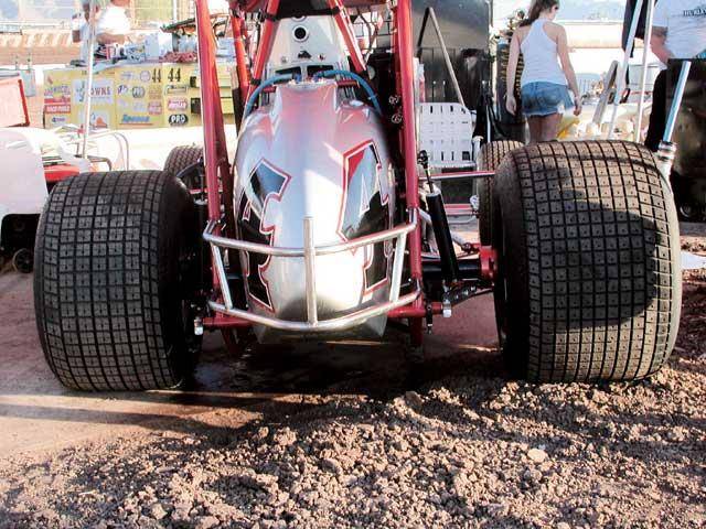

Mid Turn handling problems usually come down to Stagger and Cross weight.

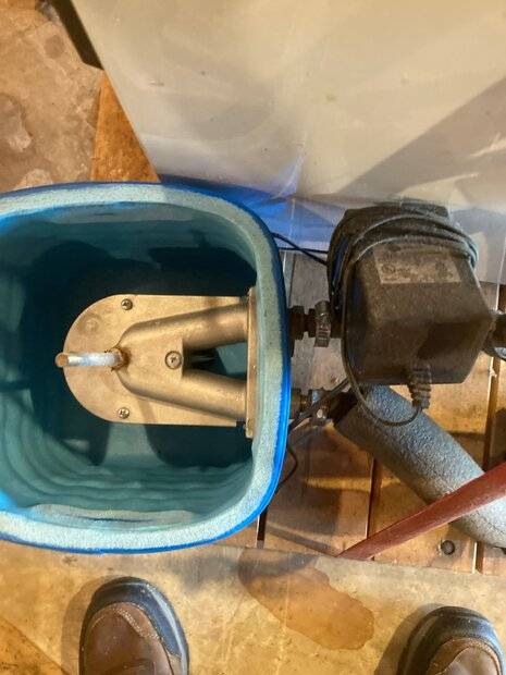

We must use Stagger so the tires will not shed going through the turn. Put a Styrofoam coffee cup on its side and roll it. The top or bog end rolls different than the small diameter bottom. On circle racetracks in USA we turn left so the left rear tire is smaller diameter then the right rear tire so assist the turning process. There is no way around this and all racers in your race must use stagger. You can, however, use a few tricks to assist you. We took an old refrigerator apart and used the vacuum pump to pump out the compressed air in our tires. We filled the tire with Nitrogen. Compressed air has moisture, and this turns to steam and expands the tire when heated and your right front tire will heat up. Nitrogen expands at a much lower rate and holds stagger longer. One side benefit is the nitrogen molecules and fatter and do not bleed through the tire side wall like air does. When the tire does expand it throws weight to the left rear tire. It adds Wedge or cross weight.
minimum stagger you need is:
D + .5 (TW) x CL \ D - .5 (TW)
where D is the track diameter in feet
TW = rear track width of the car in feet ( divide inch measurement by 12)
CL = the left rear tire circumference
example- race track has 200 ft. diameter
car has 64 inch track (64 / 12 = 5.33 inch)
left rear is 86 inch circumference.
run the numbers and you get 88.33 inch right rear circumference or MINIMUM 2.33 inch stagger. If you run a locked differential or spool we add 10 percent to minimum stagger. If the track banking is 0 to 10 degrees, add another ten percent. If banking is 15 degrees up, take off ten percent from min. stagger.

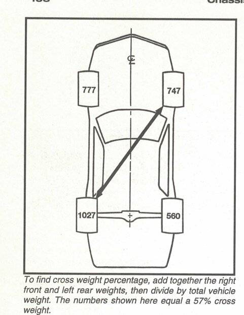

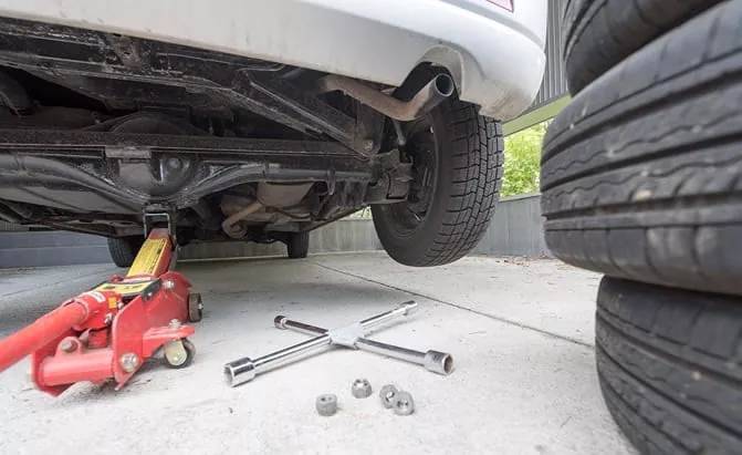

Checking for Wedge – Crazy! I spent an hour googling and no photos of this. Word picture time. When the race car enters the turn the left rear spring goes into droop because the spring is extending to its max travel and the right rear spring is compressed. The left side droop means the left rear tire has minimum traction. We use wedge (cross weight) to increase tire load on the left rear tire. This increases tire bite off the corner. We attained this with the jack screws we have on the car. We add cross weight or Wedge to force the left rear spring into the track when cornering.
We measure Wedge with a ½” socket placed on the floor jack and center it under the rear end housing to lift both rear tires. The right rear should lift up an inch, 2 inch or 3 inch as the track demands, just as the left rear tire shows daylight under the contact patch.
In the turn, the body will roll over and the wedge drives the left rear to wedge the tires to keep in contact. The % cross weight on street stock is usually 1 to 2 % total weight, Late models with slicks run 2% typically.
Rule of thumb - every inch of wedge is 1% Cross weight. When the wedge goes past the normal amount (and inch more than what the normal amount is) then make a left rear spring change. Then reduce the wedge to under the normal amount and adjust at the track as required. Cross weight is adjustable because the local track will change due to temperature, amount of rain washing off the oil and rubber, etc. You need to have a way to dial the chassis in for new conditions and not use it up for basic chassis setup.

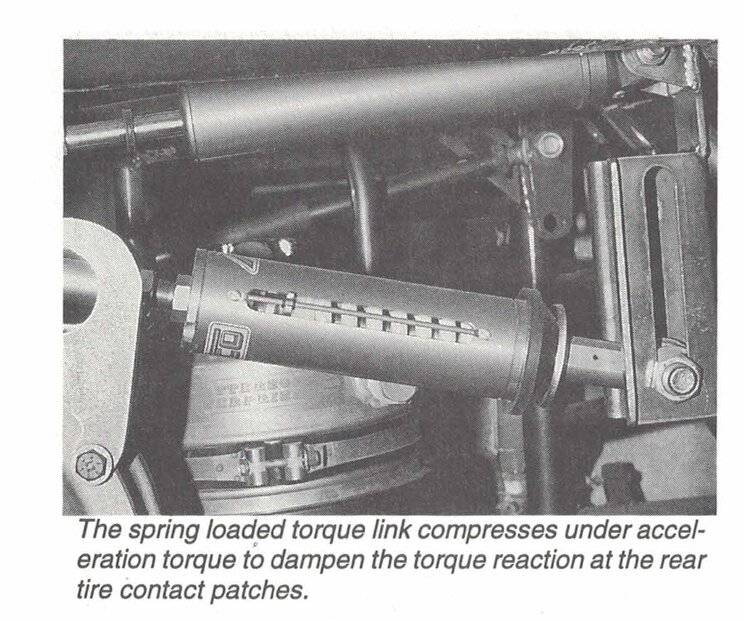

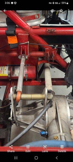

The problem

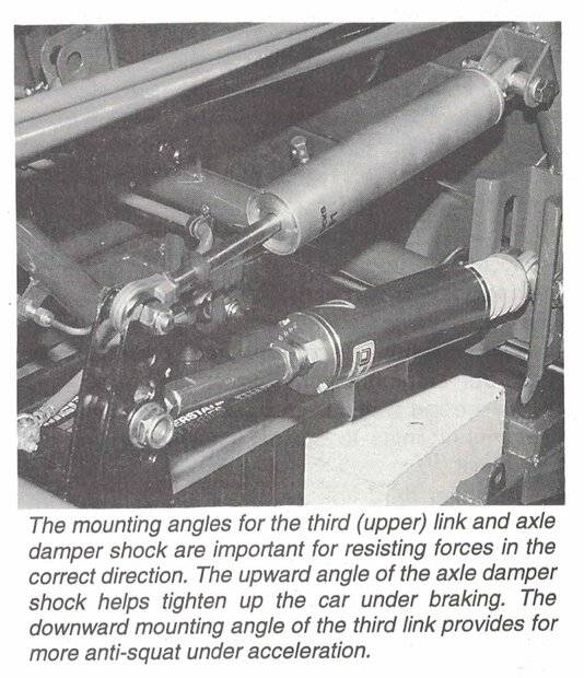

The location of the top link on any factory chassis is about a 52% left side weight set up on the standard 4 inch offset wheels and the tire track width. A very logical and safe starting point. Unless you ordered it with a specific requirement to change these settings.
The problem is the 3rd link is mounted at the original 52% weight location and should now be at the 58% location and it is not.
Why is top link mount so critical? The top link is the rear end link that pulls the race car. This top link directs all rear end force to the chassis. The rear tires grip the track and try to pull the rear end to the rear. On the bottom, the trailing arms push the car to the front and try to climb up under the car.
We are discussing left turn race car where you want a left side weight bias. When in a turn you want the left side weight rolling over to the right side to assist the car with better traction (tire grip). Correct location of the 3rd link mounting is a real help so the tires are pulling on the third link equally otherwise when you step on the gas, one tire will bite more than the other and shoot you toward the outside of the track or the inside.
If the 3rd link is offset to the left more than the right side, the left will have more load and the right rear tire will have less load. Exactly opposite of the muscle car scenario above. What really happens is more force is added to the side of the car the link is biased to. In this case we have more force added to the left rear tire, so we create an on gas, corner exit LOOSE condition.
The 3rd Link Location (Static)
Mark each rear tire centerline. Measure the distance between them. This is the track width. Let's say 66 inches so the mid-point is located at 33 inches. Now measure the right-side tire centerline to the middle of the top link. Let's say it is 34 ¼ inches. 34 / 66 = 52% left side weight. If you are scaling at 58% left side weight we multiply the total track width time the % so 66" x .58 = 38 ¼ inches. The top link mount should be at 38 ¼ " so, move it left 4" then the push goes away.

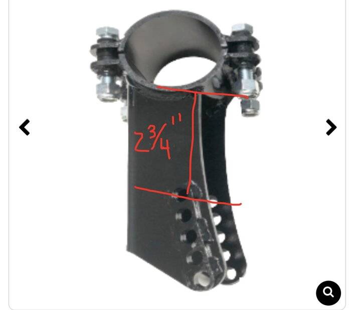

See attached photo a forum member, RaceMan12 posted on page 46 post 1602 this post. You can make this happen.
Look at photo below. Notice the original top link mount was offset about 1 ½ inch to the left of the quick-change housing centerline. The racer relocated it about 4 inches more to the left. See post # 1576 page 46.
This is a huge step to solving the traction problem and it will only get you close.

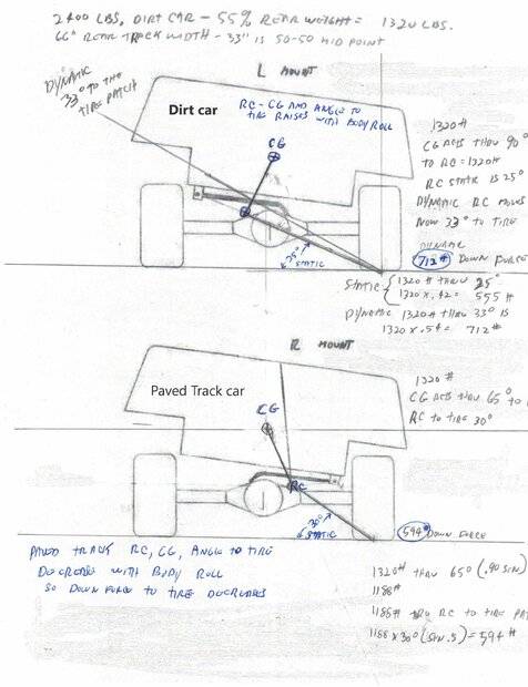

The 3rd Link Location (Dynamic)
The problem is that this is a static fix. Look at the cross-weight illustration below. We have left rear tire weight of 1027 # and right rear tire weight of 560# when we scale the car. We use the Static measurement of % left side weight to locate and center the 3rd link to provide 50-50% traction.
This remount does not take into account the dynamics of corner exit. Look at # 43 car lifting the front end under acceleration. It is also twisting and throwing left side weight over to the right side. We have to dial this additional left and rear weight into the equation.
Let us say we have 100 lbs. weight coming of the left front tire and dumping on the right rear tire under acceleration. The car is twisting and unloading 25 lbs. from the left rear tire and it goes to the right rear tire
Now we have a dynamic left side % weight of
Lft ft rt ft
677 747
Lft rear rt rear

We now have 54% left side weight under acceleration.
How to properly measure the dynamic weight transfer?
Take the car in full race trim to a straight section of road parking lot, airfield.
Set the damper (shock absorber stops) and make a full power acceleration for 50 feet. Do not brake, coast to a stop, let the chassis settle. Read the shock travels on all four corners.
Next step is to scale the car and floor jack the chassis in front and on left side to duplicate the shock travel you recorded.
You can read the weight scale on each wheel to find a truer dynamic left side weight % and then calculate 3rd link position for a much better 50-50% rear traction.
We have now calculated the Static 3rd link location and the Dynamic 3rd link location. Somewhere on this range will be your maximum traction location. When relocating the 3rd link mounts both at chassis and on the rear end, make it adjustable so the link can be shifted from left to right. I recommend a few 1/4 “thick spacers and many Spacers. ½ “spacers. This way you can dial in the location for maximum traction.
Testing best location of 3rd link Spend a Saturday at the parking lot doing nothing but launching the car. I would recommend using some orange traffic cones to mark out the radius of your turn number one of your local track, on your parking lot. We are seeking best corner exit 3rd link location under power during this outing. We have a pretty good idea of static and dynamic location but to optimize it we need to drive around the radius at speed to throw some rear and left side weight and nail the throttle. This will truly give the best 3rd link location.
Get car in race trim with an old set of tires. Make sure the stagger is right. Work on hook up of both rear tires so you have straight Gas on acceleration when you mash the go pedal. Adjust until you go straight and leave equal tire marks on the pavement. (You do not need to leave tire tracks though it would help). The point is to launch the car and adjust so it goes straight when you gas it on corner exit. When you can take your hands off the wheel when you gas it and it shoots straight, you got it.
If it wants to drift to the left, move the 3rd link a little to the right until it runs straight. Use the tire pyrometer so both tires are getting the same heat (load) on launch. This is very hard to do because you need to compensate for the smaller diameter left rear tire.

One final thought - do drag car tune with rear roll center? NO! This is for working out phase one and two cornering problems. Do not forget you have two cars, not one.
Yes, this takes time but if you can tune the rear traction without screwing up the corner entry, it got my vote!

Many thanks to RM for this forum, I started racing less then a year ago & was always at the back, found this forum after last race of last year & moved third link & used the track tuning tips above with the tire pyrometer. My first race this year I didn't get a chance to take tire temp readings after the feature but that's a good problem to have. I also forgot a big enough box. My car has never been so consistent. The next race will be more challenging for me as I will have to start from the back. I owe my first win to this forum & a little luck!!! Thanks again to everybody keeping this forum alive!!!
Reply
Thank you for the kind words. An inspiration to all of you racers. It is not me who does the hard work, long winter nights under the car in a cold garage! But you all know the feeling once you start getting real close!
Good Job Low Bud!
We use the torque link to help hook up t he hard spec tires we have to race! This lets us dial in amount of rear traction and it is one of the best ways to aid corner exit with the tires we have to run.
Thanks again to Paved Track Stock Car Technology by Steve Smith! A lot of tuning advice on this in this book.
Torque link or 3rd link with spring / shock top link or the toque link should be mounted 12 to 13 " at 3rd link location desctibed in previuods posts. Once you figure this, mount it on top of the axle housing, and 1 to 3 inch behind vertical center line of axle housing.
Angle the top link downhill about 20 degrees. And usual adjustment is between 15 to 25 degrees. On asphalt we run 3 to 7 degrees.
Adding more downhill angle will tighten up the car under power off the corners, but the hook up does not last as long and by using a lesser angle the car will hook up more smoothly but not as quickly.
you may want to add a shock damper to the 3rd link mount. this will control rear end looseness and wheel hop under braking. The axle damper should mounted 5 degrees up hill. Never mount it level or downhill. If the rear end loosens persist at corner entry use more axle damper uphill angle adding no more than 2 degrees at a time. max 7 degrees uphill angle on dirt.
If rear is too tight at corner entry decrease downhill angle.
Lower trailing arms usually mount 3 to 5 inches below axle center line. The most common center to center length for lower trailing arms is 20 inches.
Lower trailing arms normally mount 5 degrees uphill. Uphill angle gives better forward bite. Both links with same angle create slight roll over steer. You can change wheelbase to control rear steer by shortening or lengthening one of the lower trailing arms. Many dirt cars run 20.25 inch right side
lower trailing arm 1/4 inch longer than left side, to increase roll over steer.

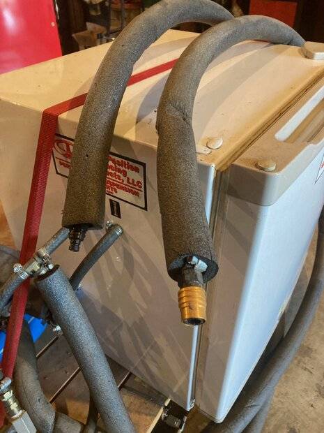

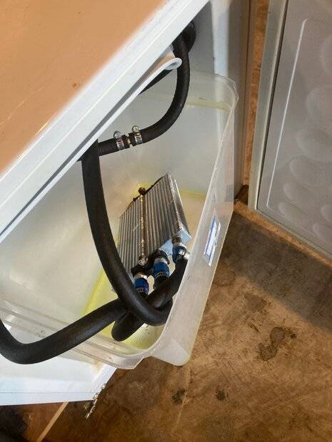

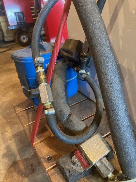

The temperature of gasoline has an impact on how much power an engine will produce. When your fuel is at a lower temperature it will have a higher density level, this allows more to enter the combustion chamber. This increased amount of fuel inside the cylinder will allow for more combustion in the chamber, thus creating more horsepower. Having fuel stay at a lower temperature also will prevent it from moving to a vapor state inside the fuel lines before it enters the engine.
What Does a Cool Can or Fuel Cooler Do?​
A cool can for fuel or fuel cooler is a device that helps regulate the temperature of the fuel in your vehicle's system. By reducing the heat of the fuel, it can improve overall engine performance and prevent fuel vaporization, especially in high-temperature environments. This can lead to a more consistent fuel delivery, increased power, and improved fuel efficiency. Cool cans and fuel coolers are particularly beneficial for vehicles that experience fuel heating issues, such as those with high-performance engines or operating under extreme conditions.
What Is the Difference Between Cool Cans and Fuel Coolers?​
Cool cans and fuel coolers serve a similar purpose of cooling the fuel, but they differ in their design and installation. Cool cans are compact, cylindrical containers that are typically installed between the fuel pump and carburetor. They utilize heat exchange technology to dissipate heat from the fuel. On the other hand, fuel coolers are inline devices that are installed in the fuel line itself. They incorporate various cooling mechanisms, such as heat exchanges or fans, to cool the fuel as it passes through the system. Both cool cans and fuel coolers can effectively reduce fuel temperature, but the specific choice depends on your vehicle's setup and application requirements.
What is desired is a way to improve the volumetric efficiency of the Internal Combustion engine. All an IC does is act as a heat pump. converting chemical energy, gas, into heat and usable power. Te more fuel you can pack into the combustion chamber, the faster you go. For years racers used a cool can to cool the. fuel. It is simply a can with a coil of aluminum fuel line mounted in it. the racer would put ice in the can before a race. Theoretically, the fuel is cooled more than ambient temperature and is a denser mixture of fuel / air thus more power. This is why older cars had chokes on the carburetors, to "choke off" the air supply in real cold weather. The choke had a thermal spring that would kick off once the IC reached operating temp. Cool can, I can testify, after much testing, is not a good solution. There not enough time or cold enough media to cool the fuel. Back when drag racing in the 1960s, we went so far as to run acetone and dry ice in the can. It froze the fuel line up to the fire wall..ran like a bat out of he--... but..our driver was overcome by fumes and started our Super Stock 63 Plymouth 426 Wedge in high gear at the starting line. These cars had the push button automatic transmission. Have you ever heard a 426 cubic inch motor lug down when the hammer is dropped at 7000 RPM?
Cool can with ice does add about 2 to 3 HP on carburetor engine s but not direct port injection setups. The carb setup means charge cooling from just under the carb to the intake valve. The colder gas mixture can cool the air and create a larger charge before entering the cylinder head. Direct port injection just squirts in cold gas with no charge cooling effect.
118° F fuel to a 10 HP gain with 58° F fuel super chilled
Anti freeze freezes at - 34° F
Acetone freezes at - 128° F
Dry ice cools to - 106° F
We did not have enough room on the formula car ( like Indy cars ) to mount the cool can and i think it would have been illegal anyway in SCCA. So I designed a fuel system to take the fuel out of t he fuel bladder , cool it down and return in to the fuel bladder. This is for the Qualifying event not the race. I used a Facet 12 volt electric fuel pump an d 120 vac to 12v adaptor. Had quick disconnect fittings and plumbed it into the fuel line and fuel tank vent line. I used a Blue moroso cool can in series with a medical freezer.
A regular freezer will cool to 20° F above zero. A medical freezer will chill to -20° F. Inside the freezer I installed a small oil cooler. It was in a plastic container that could hold a gallon of antifreeze.
Why the freezer? Many tracks are located out in the boon docks and i could not depend on getting dry ice readily. We always had a gas generator to power the air compressor, coffee maker, microwave. So on boon dock tracks the freezer would freeze to minus 20° F and we would cool t he fuel for qualifying. I would put ice in the moroso cool can so the fuel would bet chilled a little before going into the freezer.
When we had dry ice available we would put acetone in the cool can and plastic container ( had to replace it with an aluminum one reall soon after t he first freeze).
Yes it worked and no one caught on. I did not have a pyrometer that would read that low so can not tell the temperature the gas was cooled to before we qualified but i can tell you there was a lot of condesation dripping from the car. We made it a point to wash the car outside the garage in plain sight just before qualifying. I made it a point to have a can of PAM (spray on canola oil you use in the kitchen) stashed under the car while washing. If you looked you could easly identify it! ( Intresting note- soon after we did this and qualified number one at a few races, a lot of other racers began washing their car and wanted to know what soap / washing mixture we were using) monkey see, monkey do!

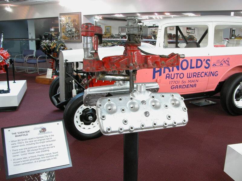

Regarding the 2 barrel carb limit - Many have messaged me about racing in the 500 cfm 2 barrel car classes and how to maximize the setup. If the rules state you must run this CFM carb, do it.
You will be surprised to learn your Holley 4412 500 cfm 2 barrel only flows 353 cfm! The new XP 4412 with stream lined air horn and all the new tricks flowed 392 cfm. Both a far cry from 500 cfm.
Can you still get an edge on the rest of the field? Absolutely. I do not condone some of the following but this carb restriction has been in effect since the early 1960s. The math I use here is extremely simplistic as real world results show my numbers go out the window when Rpm goes up and dynamic flow kicks in. I will not be addressing the rework of the carb as you can pick up 50 cfm by just polishing and porting , smoothing things internally. See video below at bottom, on reworking stock carb

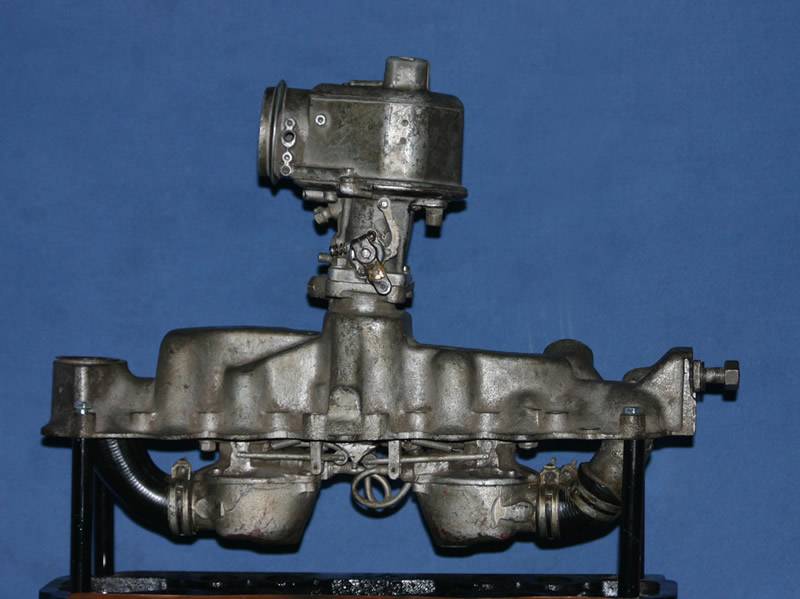

Lets look at the numbers. A Holley 500 cfm 2 bbl carb has venturi diameter of 1.3/8". There are 2bbl carbs with 600 cfm and have 1.45 diameter venturi. First thing was to keep open one of the intake manifold holes used to draw vacuum. Tech would make sure these were all capped but is did work. You can run a vacuum gage into the cockpit and if it happens to slip off during the race you may get and increase. A 3/16" hose will yield 0.11 sq inch.
Back in 1950, one race team set up the car so the carb was mounted with springs on top of the carb mounting flange. When the driver mashed the throttle pedal the carb would be jerked rearward and air would enter the intake manifold. Of course they jetted for the fat side and won a lot until TECH caught on. Next the boys drilled the carb mounting threaded bolt holes thru the manifold. Now you can have air enter the intake. The trick here is to use a 4 barrel intake manifold and use a 2 bbl to 4 bbl adaptor plate. Now you have 8 bolts that can be drilled out , cross drilled. It simply looks like the bolts have been cross drilled for safety wire. These holes can access the plenum chamber in the manifold under the carb. Serrated washers look like they are threr to lock the bolts but really can pas a lot of air as they do not mate flush to the carb or adaptor plate. This was pretty obvious once TECH caught on to it. Next thing tried was milling or filing a taper on the carb manifold mounting surface on both front and back sides but leaving the left and right side stock so the carb would mount flat but had a taper air leak under the carb. This gave additional air area to the intake. Bottom line is if you choose to go this route be prepared to be caught!
https://www.holley.com/products/fue...MIpMeNxbnjgAMVeQitBh1OGAXqEAQYAiABEgJIiPD_BwE
Looking at the area the 1.378 bore has 5.9 sq. Inch area. The 1.45 dia. has 6.6 sq. inch. 5.9 - 6.6 = 0.70 sq. inch difference. I will leave it here as you have a major clue about what you can do. Now it is up to YOU!
see below - stock 256 cfm two barrel carb to 300 plus
https://www.vaautoracing.org/oval6.htm
How to hide two carbs under the intake manifold, 1950...
https://www.museumofamericanspeed.org/cheatermanifold.html
hiding carb under the intake manifold.

Lowers can be raise but bower moved down. Must bolt within 2 3/4” of bottom of housing.

Photo of Roll center lay out says it is located to the left of center. You said it was on passenger side???

not knowing if the ft rc is offset to the right side as recommended, i can only guess you have too soft a frt spring package making car nose heavy and not enough weight on rear to hook up tires on corner exit.

Front Roll center drawing is from a front view looking back, as if you were standing in front of the car looking at it, driver side on right, passenger side on left. Roll center is on passenger side.
The lower trailing arm bracket has multiple mounting holes underneath the housing but can only be a max of 2.5” from bottom of tube to the center of the bolt. I’ll attach an image below. I can not move the mount to a lower bracket hole but I could drill another hole above it.

I would say you are in a very good position. Roll center is ok so corner entry should be good as you u stated. You know the problem on rt rear regarding tire temps. It still looks like a spring change though. cannot tell until the tires are at best camber, inflation so total spread from inside middle and outside is 10° on spec tires. Typically, the right rear temp average should be between 10 to 15° cooler than the right front average. Seriously consider the springs recommended.
