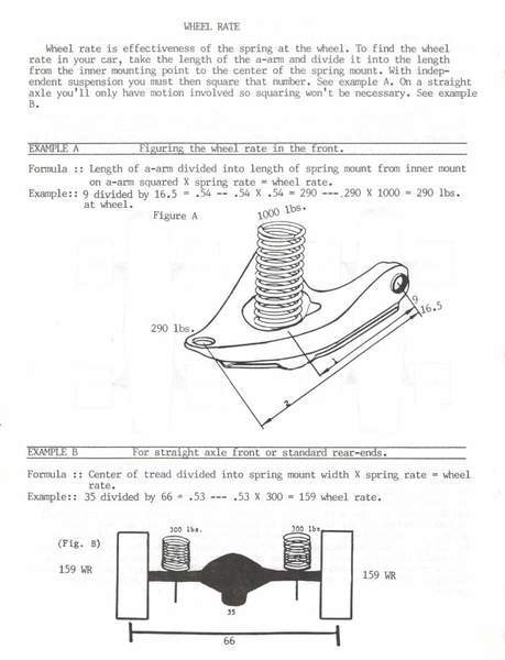

what is motion rate of the spring? Now this makes sense.
i assumed you were running stock A-arms. are you running slider attached at different angles and mount point from stock? look , if you want my help...tell me your setup!
  • #1,745
Ranger Mike said:
what is motion rate of the spring? huge!!
I’ll have to get you that information later tonight or next weekend. I’ll measure middle of inner pivot point -> center of spring then inner pivot to outer ball joint. MR= D1 / D2
I figured that’s what you were getting at because I realized where those spring rates you recommended were coming from. Keeping the car up off the frame.

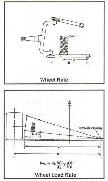

If you have GM metric A-Arm and have 700# spring in stock location
not enuff, too nose heavy , loose off

I did get to check the MR on every corner but the RF
LF 2.5” shock travel to 1.5” spring travel(5:3)
LR and RR and pretty close to a 1:1 ratio
RF Guesstimate based on load stick #’s would be a 2” spring travel to a 4” shock travel 1:2
No spring sliders. Springs sit on a cup mounted atop the center of the axle tubes, vertically 90°
The rear shock have a screw stud mount aft of the rear end tubes that comes down from above at pretty close to 90° and mount on the back side of the of the lower trailing arm bracket.

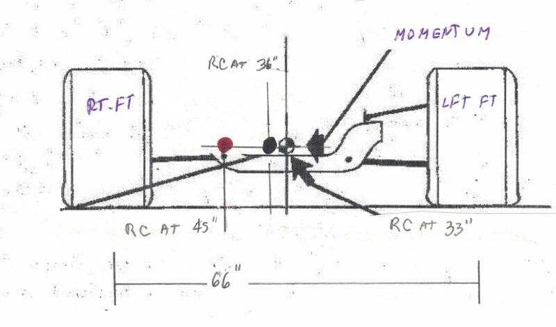

Front roll center offset too far to right will lift up the left side of the car. Has too much leverage. This will load the right rear tire heavily under acceleration. This will heat up the right rear tire and make you loose traction to the point that you totally loose all traction on that tire. From earlier conversations I thought you had the roll center pretty on track? Do not make major changes until you fox the frt roll center offset to 3 to 3.5 inch to right. You can change the rear spring to go a little softer but we do not know is causing rt rear tire temp to be so big? Could be roll center or springs. In any event you have to fix the ft roll center first. Then spring swap is easy.
  • #1,766
I did have it set pretty well but we’ve rescaled it and lowered the car 1/4” since. Also took my measurements without someone sitting in the car so I’m sure it’s off a tad. I’m going to take another look at in today and rerun the numbers.
  • #1,767
Why RC location can be too offset
Let us look at a Late model asphalt Car weighing in at 2800 lbs. with 66" track width. If we calculate the unsprung weight total we have about 500 lbs. leaving 2300 sprung weight.
If we place the front Roll Center (RC) mid point we have it located 33" from the center-line of the left front tire. If we place the 2300 lbs sprung weight on the chassis we will see that half of this weight will rotate thru the RC to plant down force on the right front tire during cornering. The other half will push sideways with lateral momentum. In simple terms we have 1150 lbs. (half of 2300) acting thru a 33" (2.75 ft.) lever (2.75 x 1150 lbs. = 4,125 foot lbs. of torque.
A pound-foot (lb⋅ft), abbreviated from pound-force foot (lbf · ft), is a unit of torque representing one pound of force acting at a perpendicular distance of one foot from a pivot point. Conversely one foot pound-force (ft · lbf) is the moment about an axis that applies one pound-force at a radius of one foot.
If we move the RC to the right by 3", we now have 1150 lbs. times 36" (3 ft.) = 3,450-foot lbs. torque because we now have 54% of the unsprung weight rotating thru the RC to plant down force on the right front tire.
Now we find the front RC is 12" offset to the right! Our RC is located 45" (3.75ft) from the center-line of the left front tire. We have a whopping 68% (45" divided by 66" track width) of the unsprung weight rotating thru the RC to plant down force on the right front tire.
3.75 x 1150 = 4,312 foot lbs. torque. This is toque will lift the left front of the car and add down force to the right rear tire. The rt rear tire will quickly overheat and loose grip or traction. Car will be real fast for a few laps then drop off the cliff!
But wait there's more! This assumes we have 50-50% left to right side weight. What if we have 58% left side weight? These figures will be much greater.
The point of this post is to show you the importance of proper RC location as step one of any successful chassis setup.

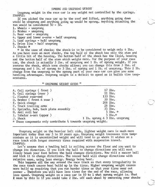

Unsprung weight table from "Short track chassis set-up" by Duke Southard
other pic from Steve Smith- Paved Track Stock Car Racing Technology -

RF to lft rear temp should be with in 6 to 10°, is is 2°, not enough cross weight - LOOSE
RR to Rt Front ave temp , the rt rear should be 10° cooler, it is 48° hotter ..LOOSE
rt rear not getting enough traction, it is spinning and heating up. It needs more weight so ft springs are too soft.
ft Springs are too soft and you need RC offset to right 3" to put down force on Rt ft tire. and you stiffened the rt rear spring!! ??????
