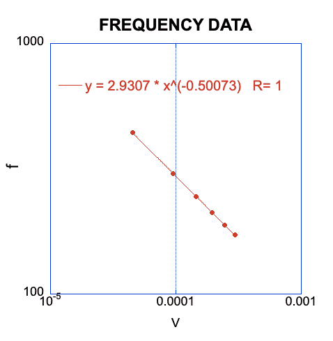

please provide the f vs V data, and I will show you what I mean. Plus, I have already answered these questions in a previous post.
V= 0,000295m^3 f=172Hz
V= 0,000245m^3. f=188Hz
V=0,000195m^3 f=211Hz
V= 0,000145m^3 f=245Hz
V=0,000095m^3 f= 303 Hz
V=0,000045m^3 f= 440Hz

now it works, thank you , with me the graph looked like a straight line, only my associated function equation y=mx+b was not as perfect as yours. Many thanks, what program did you use?
  • #34
Kaleidagraph

Chestermiller said:
so that's the last question, how can I determine cs from this function equation between f and v now?because $$ y=kx^n $$
that describes only f and V in the diagram, can I determine cs with the help of these straight lines?
  • #38
$$k=\frac{c_s}{2\pi}\sqrt{A/L}$$
