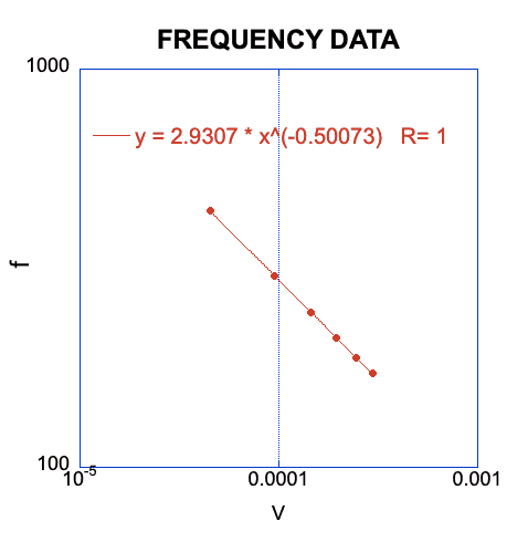

Hello,
The formula:
is to result in a linear relationship between a function of frequency f and a function of volume V.
my idea would be f² and 1/V is proportional, but the graph should result in a straight line
$$ f=\frac{cs}{2\pi}\cdot\sqrt{\frac{A}{VL}} $$

i will show you my steps:
\begin{align*}
f &= \frac{c_s}{2\pi} \cdot \sqrt{\frac{A}{VL}} \\
f^2 &= \left(\frac{c_s}{2\pi}\right)^2 \cdot \frac{A}{VL} \\
f^2 \cdot \frac{VL}{A} &= \left(\frac{c_s}{2\pi}\right)^2 \\
f^2 \cdot \frac{L}{A} &= \frac{1}{V} \cdot \left(\frac{c_s}{2\pi}\right)^2 \\
\end{align*}

$$ f = \frac{c_s}{2\pi} \cdot \sqrt{\frac{A}{VL}} $$
$$ f^2 = \left(\frac{c_s}{2\pi}\right)^2 \cdot \frac{A}{VL} $$
$$ \frac{1}{V} = \frac{2\pi f^2 \cdot L}{A \cdot c_s^2} $$
$$ \ln\left(\frac{1}{V}\right) = \ln\left(2\pi f^2 \cdot L\right) - \ln\left(A \cdot c_s^2\right) $$

$$\ln{f}=C-\frac{1}{2}\ln{V}$$where C is a constant equal to:
$$C=\ln{\left(\frac{c_s}{2\pi}\sqrt{A/L}\right)}$$So a graph of f vs V on a log-log plot will be a straight line with a slope of -1/2.

I wouldn't bother with logs. When you square both sides, you get
$$f^2 = \left(\frac{c_s}{2\pi}\right)^2 \frac{A}{VL} $$
Let ##y=f^2## and ##x=\dfrac{1}{V}## presumed to be the dependent and independent variables respectively. I assume that this is an experiment where you varied ##V## and measured ##f##. Presumably ##A## and ##L## are measured constants and you want to determine the speed of sound ##c_s.##
If you plot ##f^2## vs. ##\dfrac{1}{V}##, the equation should be a straight line that passes through the origin and has the form ##y=mx## where the slope ##m## is $$m=\left(\frac{c_s}{2\pi}\right)^2 \frac{A}{L}.$$You can do linear regression and find a value for ##m## which you can use to extract a value for ##c_s.## This would be harder to do if you use logarithms.

Thank you very much! I tried their equation and it worked! The graph looks good too. What do you call the x and y axis? And can you also use the logarithms to form a linear relationship between a function of frequency f and a function of volume V?or is the equation you gave me already the linear relationship?

You label the x and y axes F and V. The equation I gave is already the linear relationship.

I have entered the normal V and f values in the diagram, does the slope have to be -1/2 when running a regression leanest through the points as in your equation. And do I have to adjust the values through the equation when I enter them
The slope is what the fitting algorithm says it is. If you expect -1/2 and it is not (within experimental error), then you have to interpret why.

There are different volume bet and accordingly different frequencies. I have recorded 7 values, so now I have 7 volume values and their corresponding frequency. @Chestermiller gave me a nice Ln equation, I put in his equation the values, you can see the linear relationship. Do I have to plot the normal values V and f without having put them into @Chestermiller equation. Or do I have to draw the logarithm values I have from the equation into a log diagram.I knew the equation and the graph as @kuruman did it before, and it works, but I would like to try the logarithm variant as well

please provide the f vs V data, and I will show you what I mean. Plus, I have already answered these questions in a previous post.
