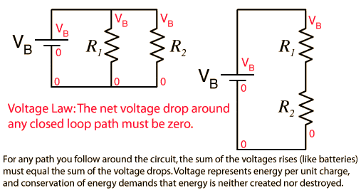

This is true but only true if a constant current is passed. In most cases (bulbs and batteries etc.) it is the voltage supplied that is constant. So beware; this relationship you seek will all depend upon the context.
If you just consider R as the ratio of V/I, you can't go far wrong.
Just thought I'd throw this in.
http://hyperphysics.phy-astr.gsu.edu/hbase/electric/ohmlaw.html"

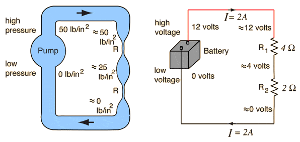

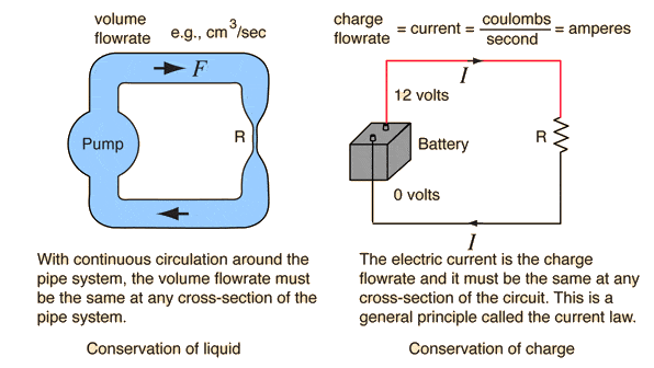

As the resistance approaches zero, the current would approach infinity. Do you know of any sources that can provide an infinite amount of power? In reality, power sources have "internal" resistance, so as the current increases, the voltage of the source lowers.
http://hyperphysics.phy-astr.gsu.edu/hbase/electric/dcex6.html"

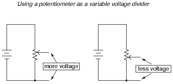

Let's consider proportionality or ratio here. Never mind current it is just a constant value. It's just the ratio or proportionality for this situation.
Let's say I get a battery of 20V connected with a VARIABLE resistor with a sliding contact. The total resistance of this resistor is 20KΩ. I would like to imagine this ratio, for let's say where will I set the resistance to output the maximum voltage or what resistance value will I have to set to output a 10V
If you place a 20 V battery across a 20KΩ resistor, a 10KΩ resistor or a 1KΩ resistor, you will always measure 20V across the resistor (assuming the battery has a comparatively low internal resistance).
I am having difficulty picturing the particular configuration you are suggesting. It would be helpful if you could provide a schematic drawing.
AM
Googl, as I said in my first response you need to use a constant current source, not a constant voltage source. If you use a constant voltage source then the voltage you measure will be that of the constant voltage source.
Okay. Thanks a lot.
I think now I have found what I have been looking for.
So am I correct by saying this or is my diagram of maximum voltage correct?
V1 = 9V regardless of R. You need a constant current source, not a constant voltage source.

Googl, here is an example of the simplest circuit diagram where V is proportional to R.
I should have added this as well.
The voltmeter is where the Vs are (V1 and V2). (The current is constant, I think I have confirm this before) The black box/bar is a potential meter and is adjustable to obtain a desired voltage at V1.
My goal is to observe how the maximum and minimum voltage would be set in the images (that might help).
By my understanding, when the knob is moved in centre the voltage drop measured would 1/2. This means the output would be 10V if the emf is 20V and set resistance 10KΩ (half of 20KΩ). At 1/4 the voltage would be 5V (resistance 5KΩ) and at 3/4, 6.75V (resistance 5KΩ)
