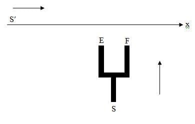

Hi,
Consider an observer S pushing a fork towards a material x-axis as seen in the figure below
According to this observer E and F cut x-axis simultaneously.
Now consider an observer S' moving along x-axis with a constant relativistic speed. It is very easy, using Lorentz transformation, to show that E and F will NOT cut x-axis simultaneously (according to S')
How is it possible that E and F will not cut x-axis simultaneously with respect to S' knowing that the none of the arms of the fork will undergo any length variation because they move perpendicular to the motion of S'?

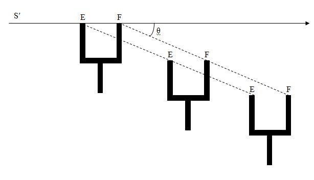

From the view of S', the fork is moving at an angle with respect to the x' axis.
Hmm, yes this is right, I have missed it; it is clear now that according to S', F will hit x' axis first.
Thank you.

Thanks to your useful reply. Actually my main problem is the mental picture. I realize that the only way for this to happen is that the fork should rotate slightly (according to S'), but I can not see any relativistic reason for this rotation.

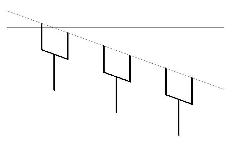

Slightly more accurately, the fork is skewed or sheared in S' as per the attached diagram, but the handle and tines of the fork are still parallel to their original orientation in S. (i.e. it is not strictly a rotation of the fork as a whole, but more of a deformation of its shape.) Note that 'shape change' is quite normal in relativity. Since length contraction only occurs parallel to the axis of motion a square in S becomes a rectangle in S'. In some situations, rotation also occurs. (e.g. if we look at the cross piece of the fork in isolation.) Look up Thomas precession.

yuiop said:
Slightly more accurately, the fork is skewed or sheared in S' as per the attached diagram, but the handle and tines of the fork are still parallel to their original orientation in S. (i.e. it is not strictly a rotation of the fork as a whole, but more of a deformation of its shape.) Note that 'shape change' is quite normal in relativity. Since length contraction only occurs parallel to the axis of motion a square in S becomes a rectangle in S'. In some situations rotation also occurs. Look up Thomas precession.
Yes, this is more accurate wording. Nice picture.

But why the fork is going to skew?
Here's an answer you won't like: because of the relativity of simultaneity. Consider the two fork ends pass a reference line at the same time in S. Then, in S', one leg of the fork crosses that line earlier. Therefore the fork is skewed in S'. You can take this back to the 'origin' of the fork: imagine it being extruded in S. If S extrudes the ends of the fork simultaneously, then S' say one leg was extruded earlier and continues to lead the other leg.
