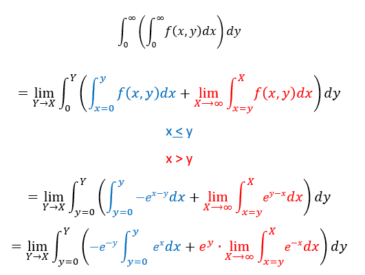

I came across an equation in a disconnected piece of my notes, and I remember that it was an instance of something, but I can't remember what. (I see how to do the integration, that is not what I am worried about.) Does anyone recognize either the function or the integration as an example of something?

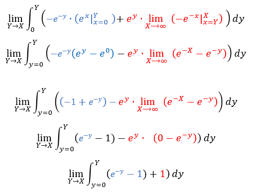

Thanks, Charles Link. Here is my integration; I would be grateful if you find my error

Both sections of the integral diverge. You can match up each little area of ## y>x ## with one that is opposite for ## y<x ##, so they cancel each other, but you can not compute either section by itself and get a finite answer. I'm not an expert on this topic, but IMO that is poor mathematics and that type of cancellation doesn't work. It is basically the step where you cancel the blue -1 with the red +1.
What you did is interesting, but it doesn't work. :)

The Lorentzian distribution is ## f(x)=\frac{1}{\pi (1+x^2)} ##. Try computing the mean and you will see what I am referring to. The mean is undefined, rather than being zero. The function is symmetric about ## x=0 ##, but when you try computing the mean, the integral ## \int \frac{x}{1+x^2}\, dx ##
is similar to what you have above. The part ## x<0 ## diverges, and the part ## x>0 ## diverges.
Edit: Note that the anti-symmetric function that you have (plus the positive values (=1) on the line ## y=x ##) gives the result (=1) that you got only with some handwaving that is not completely valid mathematically.

Edit: I'm reading the OP again though, and it looks like you have the negative values on the line ## y=x ##. If you work through your post 4 more carefully, you might find you were not consistent with your limits of integration.

The function ##f## does not have a well-defined integral. This means that when you attempt to decompose the 2D integral into two nested 1D integrations, you can get different answers depending on how you choose the decomposition.
I believe the decomposition given in post #1 does indeed give an answer of ##+1##. However, if you were to integrate ##y## first and ##x## second, you'd get an answer of ##-1##, and if you integrated along lines in another direction you could get zero along each line, or ##\pm\infty## along different lines in yet another direction.
You can tell ##f## isn't integrable because ##|f|## isn't either, and there isn't any way to decompose the integration of ##|f|## to get a finite answer. (See Absolutely integrable function.)
This all goes to show that playing with ##\infty## is dangerous.

If you do the ## dy ## integral on the lower right from ## y=0 ## to ## y=x-\Delta ##, that later results in an uncancelled term after a Taylor expansion of ## -\int\limits_{0}^{+\infty} \Delta \, dx ##. It appears you could assign almost any value you wish to this integral. Thereby I think the problem statement in the OP isn't entirely valid. Even with some handwaving it remains not well-defined.
