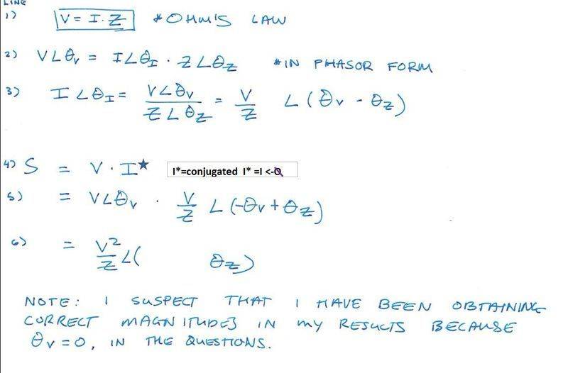

Hi All,
In doing some practice RLC series circuit question, I have been obtaining incorrect values for active and reactive power. The magnitudes I obtain are correct however the sign of the value is not. I have attributed this to obtaining an incorrect argument for the absolute power, or computing phasors incorrectly. I have attached an image of the reasoning behind my problem solving however I must be fundamentally wrong somewhere.
  • Handwritten derivation in phasor form: V = I·Z, then I∠θI = V∠θV / Z∠θZ = (V/Z)∠(θV − θZ), then S = V·I = V∠θV · (V/Z)∠(θV − θZ) = (V²/Z)∠(2θV − θZ), with a note that θV = 0 in the questions.
S=V.I*=(V.ejα).(I.ejβ)*= (V.ejα).(I.e − jβ)= V.I.ej(α − β) = VIcos(α − β) + j.VIsin(α − β)
I*=conjugated electric current α=θv ; β=θv-θz ;α-β=θz
Then S=V^2/Z.ejθz
  • Handwritten derivation in phasor form: V = I·Z (Ohm's law), VLθv = ILθI · ZLθZ, I = V/Z with angle θv − θz, then S = V·I*, I* = I<−θI, and S = (V²/Z) at angle θZ with the final angle partly written.
