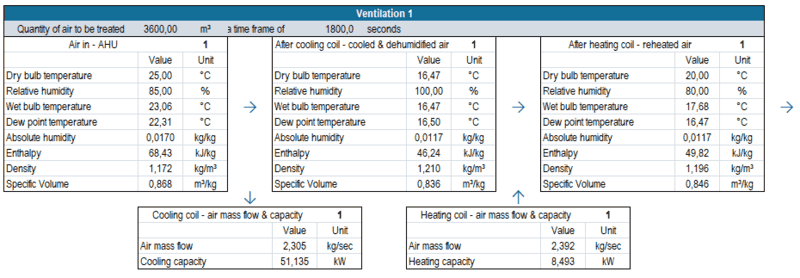

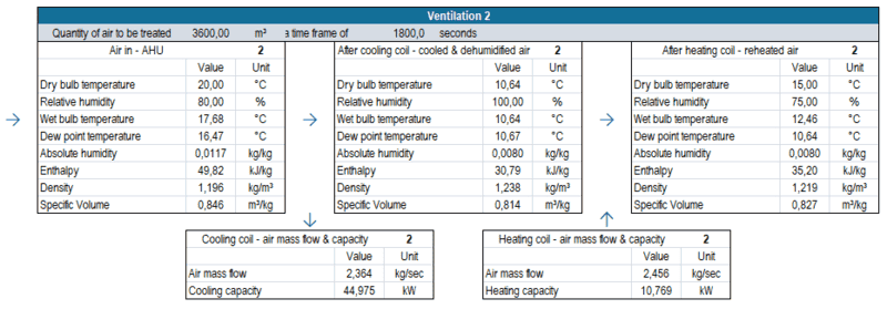

I am trying to calculate how much power I need to cool and dehumidify a room in combination with reheating the air for comfort.
The thermodynamic calculations seem to be correct. However, I'm not sure about the time factor.
My doubts are caused by the fact that there are several ventilations per hour and therefore also varying needed power.
The goal of the calculation is to pass on the required kW for the configuration of the cooling coil and heat coil to the supplier, who makes the coils.
The input data and the progress of the process in the attached images. For simplicity I have omitted all external factors (such as heat loss and, for example, moisture / heat production by people). In addition, it is important to mention that it is a recirculation process. No air is supplied/mixed from outside.
My question is, what number of kW is correct and should I provide to the coil supplier?
Cooling coil:
A: (Q1coolcoil / 2) + (Q2coolcoil / 2) - the division by 2 because each ventilation takes 1800 seconds.
A: (51,135 kW / 2) + (44,975 kW / 2) = 48,055 kW
B: 51,135 kW
C: 44,975 kW
Heating coil:
A: (Q1heatcoil / 2) + (Q2heatcoil / 2) - the division by 2 because each ventilation takes 1800 seconds.
A: (8,493 kW / 2) + (10,769 kW / 2) = 9,631 kW
B: 8,493 kW
C: 10,769 kW
My gut tells me that Im converting answer A to kWh. But I'm not quite sure. Or is this right and is kW expressed in a time frame of 1 hour?
Who can explain to me what mistake I'm making?
Many thanks in advance,

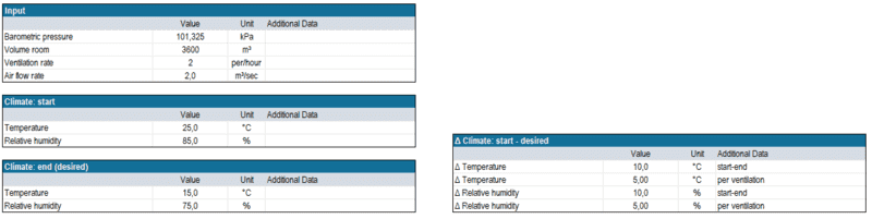

Four input tables and a change table: barometric pressure 101.325 kPa, room volume 3600 m3, ventilation rate 2 per hour, air flow rate 2.0 m3/sec; start 25.0 C and 85.0% RH; end 15.0 C and 75.0% RH.
Table of HVAC psychrometric results for Ventilation 1: air at AHU inlet, after cooling coil, after heating coil, plus cooling and heating coil air mass flow and capacity.
Table of HVAC air-state values for ventilation 2: air in AHU, after cooling coil, after heating coil, with cooling and heating coil mass flow and capacity tables below.

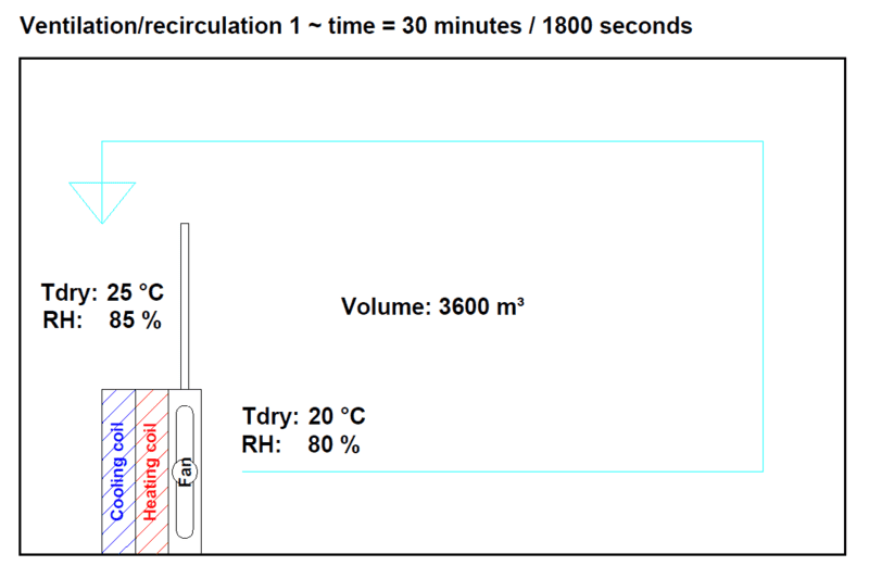

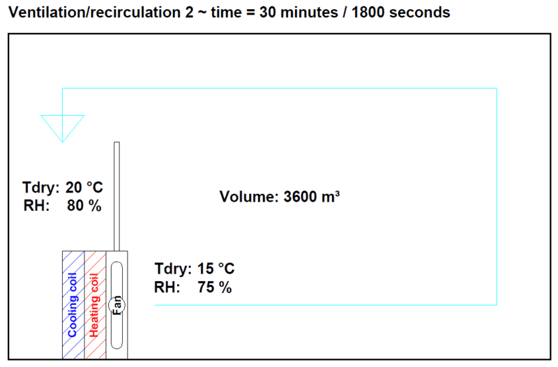

I will try to clarify the situation. I also made 2 ''sketches'' to express the process, check the attachment.
Situation:
* A room with a volume of 3600 m³.
* The air in this room is treated by an air handling unit that is located in the room.
* For simplicity, we assume no external sensible/latent loads influence the process.
* We assume a perfect airflow. The same cubic meter of air only returns to the AHU after 1800 seconds.
* In 1 hour, 2 recirculations are made.
* At the start condtions in the room are:
- Tdry = 25 °C
- RH = 85 %
* After 1 circulation (1800 secs) the condtions in the room are:
- Tdry = 20 °C
- RH = 80 %
* After 2 circulations (3600 secs) the condtions in the room are:
- Tdry = 15 °C
- RH = 75 %
My qeustions: How do I calculate the required power (kW) for the cooling & heating coil?
I hope my explanation has been clarified.
Thank you in advance,
Schematic of a room air recirculation loop: an air handling unit with cooling coil, heating coil and fan at lower left, supply air at 25 °C and 85 % RH, room volume 3600 m³, room air at 20 °C and 80 % RH after 1800 seconds.
Schematic of a room with a 3600 m³ volume served by an air handling unit with cooling coil, heating coil and fan; air at 20 °C, 80 % RH returns to the unit and is supplied at 15 °C, 75 % RH.

I checked your "Ventilation 1" calculations and the math and process works out. It's a straightforward cooling and reheat process to achieve a desired output temperature and RH from a given input temperature and RH (and airflow). The answers you got in kW are the correct answers.
But, I agree with @Lnewqban that the overall description isn't a standard HVAC processes/calculation. Such calculations are generally done in a steady-state, and this looks like a time-to-cool process. Maybe that is really what you need, but it is very unusual.
For the coil performance to provide the vendor; most I deal with do their own calculations of load based on entering and leaving conditions anyway. So I'd give them both stages and let them figure it out from there. But be aware that the true performance may differ substantially from what you calculated. If, for example, the cooling coil is a chilled water coil, you are likely to get much more cooling for the first stage than from the second, due to the larger approach temperature (difference between air and water temperatures).
KW is just kW. It's thousands of joules per second. The time parameter is already correctly in seconds from your flow rate. No conversions needed.

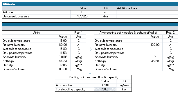

While we're at it and with this topic, I have one more question.
When I want to reverse the calculation process, I can't quite figure it out.
The data of the incoming air is known.
The air mass flow is known.
The relative humidity after the cooling coil is known.
The cooling power of the cooling coil is known.
The barometric pressure is known.
With this data I can calculate the enthalpy2 by means of:
Enthalpy 2 = Enthalpy1 - (cooling power / air mass flow)
Enthalpy 2 = 44,23 KJ/kg - (30 kW / 4,146 kg/sec)
Enthalpy 2 = 36,99 kJ/kg
Is it possible to calculate the absolute humidity with these 2 known parameters (100% RH and 36.99 kJ/kg)? I've tried various ways but it doesn't work.
When I have solved the absolute humidity I can also calculate the rest.
Thank you in advance!
Spreadsheet with altitude 0 m and barometric pressure 101.325 kPa, air-in state at 16.00 C dry bulb and 80.00 % RH, air after cooling coil at 100.00 % RH and enthalpy 36.99 kJ/kg, and cooling coil air mass flow 4.146 kg/s with total cooling capacity 30.0 kW.
BigNick said:
Is it possible to calculate the absolute humidity with these 2 known parameters (100% RH and 36.99 kJ/kg)? I've tried various ways but it doesn't work.View attachment 322416
Where are you getting the properties of air from to begin with? Are you looking them up on a psychrometric chart? If you have any two properties you can find your state point and get the rest from the chart.
The properties stated at ''Air in'' are just random (matching) properties as an example. My goal is not to have to use the psychrometric graph to read values. I would like to be able to calculate this after, for example, cooling & dehumidificate moist air.
Ashrae literature has so far helped me a lot to solve formulas/equations. But I can't solve the equation to calculate absolute humidity using enthalpy and relative humidity (and barometric pressure).
Hope you can point me in the right direction :)

There is no simple equation for it. At best it's a curve fit. That's why the chart is used.
