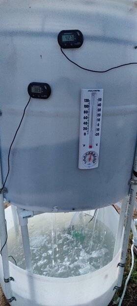

So... a cooling tower worked, sort of, I didn't measure the output of the flame, but based on the time it took to go from 32 to 60ish I would say its about 2kw, I also added a 1.5kw heating element. The system has been running for a couple of hours now and it seems to be stable. The next step is to get proper fill (I improvised with bubble wrap and gutter foam as fill) and get a more consistent heat source, like a propane torch.

https://en.wikipedia.org/wiki/Cooling_tower#Counterflow
organiclatte said:
So... a cooling tower worked, sort of, ...
That is what I call a real experiment.
You need something like a shower rose, to produce many small droplets with a large surface area, over the whole of the tower area. Higher towers work better. The tubular sides prevent the water blowing away in the wind.
As the droplets fall, some water evaporates from the droplets, which cools the droplets.
The hot droplets also warm the air, which rises creating a natural draft.
The system works best when there is low humidity in the air.
Air rising from the tower is warm and saturated, so a mist should form above the tower when it is working well.
