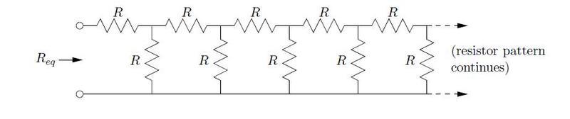

See figure
Rs = R1 + R2
Rp = (R1*R2)/(R1+R2)
I tried completing one repitition of the pattern to see if I could figure out what the Req would be so:
R + R in series on the end so 2R // R so 2/3R in series with R so 5/3R and the pattern repeats.
How do I figure this out?

since the chain is infinite, you can break the chain at any point that gives you some finite arrangement of resistors connected to an infinite chain of resistors as long as the new infinite chain begins exactly like the old infinite chain began.
Then, the equivalent resistance will equal some transformation of those finite resistors and the equivalent resistance, because the new infinite chain can be thought of as Req as well.

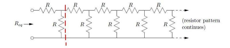

Does that mean I can simpy do this? (See figure)
If I cut it there it would repeat the same pattern after, no?
Yes, I believe so.
So then my answer would simply be 2R, no?
NO! That mesh analysis I posted was wrong, and I even labeled as such. I was hoping someone could tell me the flaw in my reasoning that led the to wrong answer.
[tex]R_{eq} = R + (\frac{1}{R} + \frac{1}{R_{eq}})^{-1}[/tex]
I'm still confused how to get the answer then, you told me I could cut my circuit where I had labeled in the image above. Would it not reduce to 2R?
No, it reduces according to the equation I wrote. Let me draw a picture. Wait a second.

How do I solve that though? The choices I have to choose from are listed as follows:
R/2, R( (1+root(3)) /2 ), R ( 1 + root(3) ), R( (1 + root(5)) /2 ), and 2R
I can't seem to reach any of those from your drawing.
Any more ideas?
I calculated it using the equation I posted, and got one of those answers. Solve for Req!
Is this the right algebra problem I'm looking at then:
[tex]Req = R + (\frac{RReq}{R+Req})[/tex]
I think I got it, is it R( (1 + root(5)) /2 ) ?
yes.
