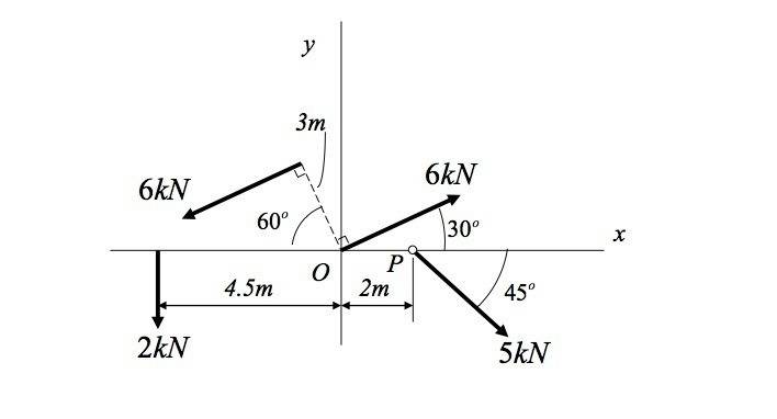

I am trying to find the resultant forces in the attached picture.
The resultant of a couple of forces = 0
F in x direction = 5cos(45)
F in y direction = -5sin(45) - 2
Therefore:
R = ((5√2)/2)i + ((-(5√2)/2)-2)j
R = √(3.53^2+(-5.53)^2) = 6.56kN
is this correct does the distance of the 2kN force come into play somewhere. If so where?

hi mm391! :smile:
looks ok so far …
now you need to find the line along which it acts (of all the possible parallel lines) :wink:
Thanks Tiny Tim but I am still al ittle confused.
What do you mean "find the line along which it acts" ? What line. All I can see it that the 2kN force acts 6 meters from point P but I am not sure how to incorporate that into the question.
Thanks
a force that is (say) 10 N north-east can be applied anywhere along a rigid body
if applied on the left side, it will turn it clockwise, if applied on the right side, it will turn it anti-clockwise
the point of application (or the line of application, through that point) matters, and when specifying the resultant of forces, you must also specify the line of application :wink:
