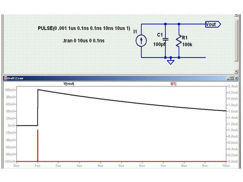

Here is a simple charge integrator for very fast pulses from a current source, like a vacuum photodiode (see attachment).
The plot shows the input current pulse (red, right vertical scale), and the output voltage pulse (black, left scale). The horizontal scale is 10 microseconds long. The light pulse (and charge pulse) occurs at 1 microsecond. A 1-milliamp, 10 nanosecond current pulse (red trace) produces a 10 picocoulomb pulse that immediately gets stored on the 100 pF capacitor (V = QC = 100 mV). The resistor drains off the charge with a 10 microsecond time constant.
Bob S

Dear Bob S,
This is very clear and this will be a practical solution for me. However, please tell me again about the references, textbooks or articles, etc that I can gain more knowledge of this field. Since I want to learn and design it myself in case the real problem is different than the one you gave me. For example, this is 1 microsecond pulse, of course I can change the parameters to make it suitable to my experiments but still this is your suggestion. I am quite nervous when I face new and different electrical problems. So please tell me where I can learn about this.
Thanks to your help, I think that my topic is fulfilled. Thank you very much!
