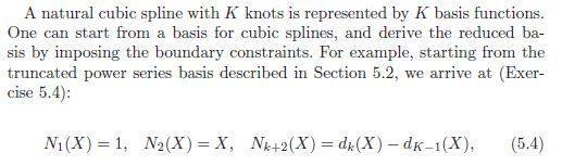

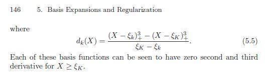

My Restricted (Natural) Cubic Spline Equation is Wrong ?
I am trying to fit a restricted cubic spline (natural cubic spline) to toy data, attempting to follow
Hastie, Tibshirani, Friedman 2nd ed. 5.2.1 p.144-146, Eqs 5.4 and 5.5.

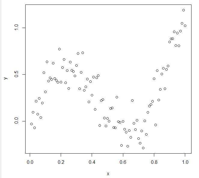

Data: Is basically a transposed ‘S’ shape. R-code is:
n <© 100
x <- (1:n)/n
true <- ((exp(1.2*x)+1.5*sin(7*x))-1)/3
noise <- rnorm(n, 0, 0.15)
y <- true + noise
plot(x,y)
I set knots at: {.2, .4, .6, .8} and am fitting using the non-linear NLS() function in R, but I can’t get the S-shape of the data no matter what I try.
My equations is wrong ? Or I am completely off-base in my approach? Any suggestions?
(Book-excerpt, my equation, and data-plot posted below)
