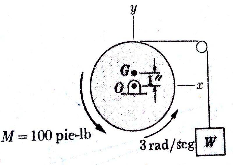

In summary, we are given an unbalanced pulley with a 6in radius of gyration and a 32.3 pound weight. A pair of 100pie.lb is applied to lift a weight of 96.6 pounds with an angular velocity of 3 rad/sec in the counter-clockwise direction. We are asked to determine the tension in the string, T, as well as the axial components of Ox and Oy for the reaction in O. Neglecting reaction friction and assuming a smooth periphery of the small pulley, the results are T=141.6 lb, Ox=-143.7 lb, and Oy=31.45 lb. In calculating these values, the equations of rigid body dynamics were

An unbalanced pulley 8in. radio. and 32.3 pounds weighing. It has a radius of gyration of 6in with respect to its axis. When a pair M = 100pie.lb applies, lifts a weight W = 96.6 pounds. In the position shown in the figure, the pulley has an angular velocity of 3 rad / sec in counter-clockwise. Determining the tension in the string T and axial components of Ox and Oy, of the reaction in O. Neglect reaction friction and suppose the periphery of the small pulley is smooth. Thanks

I try to raise the equations of rigid body dynamics, but I'm nowhere near the result. I think I have to take into consideration the imbalance of the pulley. How should raise the equations? Thanks
Whether they are correct or incorrect, please show us what you have tried.
I try this:
∑F=m.a
T - m.g = m.ay
T = m(ay + g)
T = 32,3 (ay + 32,2)
I need to calculate ay.
ΣT=IO.α
T.6in = IO.α
6T = (½ . m . r^2).α
6T=(½ . 32,3 . 6^2) . 3
T = 289. This result is not correct
