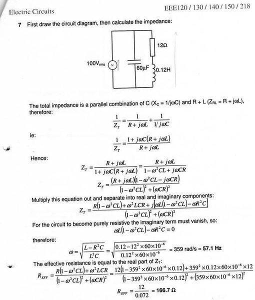

Find the frequency at which the circuit becomes purely resistive and calculate the effective resistance.
Here is the circuit with the given solution-
Handwritten worked solution for an RLC circuit: a 100 V rms source feeds a parallel branch of a 60 µF capacitor and a 12 Ω resistor in series with a 0.12 H inductor, followed by the impedance derivation and the resonance frequency and effective resistance calculation.
The trouble is, whilst the solution is simple enough, there are many places to go wrong, and the whole process is time comsuming. I've managed to simplify a few other answers given in this answer booklet, but for this one, i can't find an easier method.
Any ideas? I can't find a similar example in Hughes.
Thanks,
Josh.
If Z is real so is 1/Z.
[tex]\frac{1}{Z}=\frac{R-j\omega L}{R^2+(\omega L)^2}+j\omega C=\frac{R}{R^2+(\omega L)^2}+j\omega( C-\frac{ L}{R^2+(\omega L)^2})[/tex]
ehild
