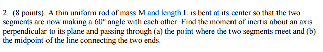

How do I use the parallel axis theorem for moment of inertia in this homework?
In summary, Homework Equations states that the moment of inertia for a uniform rod mass and length is (1/3)ML2. Parallel axis theorem states that in order to solve for a certain equation in terms of another, you must use the parallel axis theorem. This theorem states that in order to solve for a certain equation in terms of another, you must use the equation for the parallel axis of a given coordinate system. Lastly, the location of the center of mass for a given object can be found by using the midpoint of each segment.

I = (1/3)ML2
Parallel axis theorem: Inew = Iold + mr2
I already solved part a) and I got (1/12)ML2. For b), I get that I have to use the parallel axis theorem but I don't know how to go from there. We have not gone over this concept yet in class (not even moment of inertia) so bear with me...
... start from the equation for the parallel axis theorem. You can look it up: the meanings of the symbols I mean.
I think you were supposed to use it for part (a) so how did you do that?

All I did for part a) was that since the rod is bent at its center, that means both segments of the rod have masses of M/2 and lengths of L/2. So for one rod, I = (1/24)ML2. For 2 rods, then it's just 1/2(ML2)

Yes, sorry, that was a typo. That is what I got. But how am I able to use the parallel axis theorem for b)? We did not go over it in class completely yet...
What is the location of the center of mass ?
The location of the center of mass for each segment of the rod is the midpoint of each segment, correct?
I don't understand the axis that it is being rotated. Is it the midpoint between the 2 ENDS of each segment of the rod? So does it boil down to a trig problem?
So then where is the center of mass of the whole bent rod?
The midpoint of the rod, at the bent center?
No, not at the bend.
Make a sketch.
Make a sketch.
Is it the midpoint of the ends of the two segments if they were connected?
No. That's the pivot point for part (b).
It should be mid-way between CM of each segment, Right?
So like 1/4 of the way of each segment?
No.
Start with the following:
That's a correct statement.
The C.M. for the bent rod is mid-way between the center of mass for each of the two segments

In my second attempt, I applied the parallel axis theorem to each segment and then added their resulting ## I_{NEW} ##s and I got the correct answer: ## \frac{1}{12} * m * L^2 ##.
My work:
## I_{NEW} = I_{OLD} + m * d^2 ##
## I_{NEW} = ((1/12) * (m/2) * (L/2)^2) + (m/2) * (L/4)^2 ##
## I_{NEW} = (1/96) * m * L^2 + (1/32) * m * L^2 ##
## I_{NEW} = (1/24) * m * L^2 ##
## 2 * I_{NEW} = (1/12) * m * L^2 ##

Yes. Of course, that's what OP got, but didn't really explain it.
If we label the endpoint ##P## and ##Q##, and the bend ##R## then we can say (from post #1) ##|PR|=|RQ|=L/2## (may need to sketch as I describe.)
Initially the axis of rotation is point ##R## ... which nobody seems to have had trouble with.
The axis of rotation is shifted to a new point exactly half way along the segment ##\overline{PQ}## ... call that point ##S##.
The angle ##\angle PSR## is a right angle. Since we also know the other angles it is tempting to try trig and/or pythagoras ... but is there any need?
If the com of the segment ##\overline{PR}## and ##\overline{RQ}## are ##A## and ##B## respectively, then we notice that ##\triangle PAS## and ##\triangle SBQ## are iscoseles triangles with ##|PA|=|AS|=|SB|=|BQ|## and we know that ##|PA|=|QB|=L/4##
Each segment therefore has ##I=\frac{1}{96}ML^2## about com, which is a distance ##L/4## from the center of rotation, and there's two of them... so:
$$I = 2\left(\frac{ML^2}{96} + M\left(\frac{L}{4}\right)^2\right)$$ ... and simplify.
Which I think Arkud noticed earlier. If I read the above correctly, that was the method used: well done.
How about the other approach - where the moment of inertia about the center of mass of the bent rod is calculated and the parallel axis theorem is applied to that?
This is how it would normally done IRL: you have a thingy that may get rotated about an arbitrary axis, so you work out the moment of inertia about the com, with the position of the com, and put that information in a set of tables or in the documentation that you sell with the thingy. Some other engineer can. then. work out the details for their particular application.
Using the above labelled diagram, the combined COM is (from symmetry) half way along the segment ##\overline{AB}## call it ##C## the distance we need is:
##\qquad \qquad d=|AC|=|CB|=|AR|\sin(\theta /2)##
## \qquad \qquad \qquad \qquad## ... where ##\theta## is the angle of the bend from the problem statement, and ##|AR|=L/4##
Notice how the angle given was chosen to have nice sines and cosines?
There are a number of other ways of finding ##d##.
You end up with ##I_{C} = 2M\left( \frac{1}{96}L^2 + d^2 \right)##
The distance from C to S can also be found by pythagoras ... ##|CS|=|RC|=\frac{1}{2}|RS|##.
You should be able to work through the steps and check that it gives the same answer as above.

I would be inclined to simply replace M with (M/2) .
You are right:... it may be clearer to have left the (M/2) and (L/2) explicit in the formula as in...
$$I = 2\left[\frac{ml^2}{12} + md^2\right] = 2\left[\frac{(M/2)(L/2)^2}{12} + (M/2)(L/4)^2\right]$$ ... may make the process clearer for people coming in cold.
