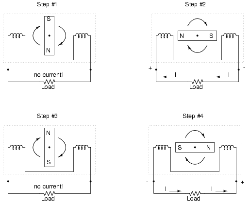

Do it like this -- put half the coil on one side of the magnet and the other half on the other side. You can space the two half-coils arbitrarily close together, if you use a short magnet. As the magnet turns, its flux goes one way through the coil, and then the opposite way as it turns to 180 degrees... Make sense?
http://sub.allaboutcircuits.com/images/02002.png
Four-step diagram of a bar magnet rotating between two coil halves wired to a load resistor, showing current direction reversing with each half turn.
