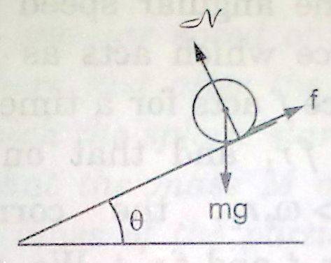

Free-body diagram of a sphere on an incline at angle θ, showing normal force N upward perpendicular to the slope, friction force f up the slope, and weight mg straight down.
The sphere is rolling without sipping, so the lowermost point has 0 velocity ... so why would there be any friction?
I know that if there will be no friction .. sphere will just slide down and not roll but still as i said ... why will there be any friction?
There will be static friction acting at the lowest point. Friction acts to prevent slipping between surfaces--which is exactly what it's doing here. Without friction providing a torque about the center of mass, how could the sphere continue to roll without slipping as it accelerates down the slope?
