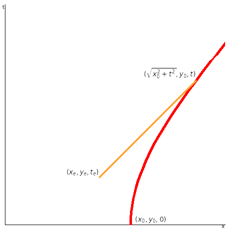

As some of you know I have been coding a 2+1D relativistic simulator that can handle (constant proper) acceleration in any direction on a plane. So far it is going quite well.
I have now decided to simulate a Sagnac gyroscope inside the simulation by sending signals in opposite directions around the square object and comparing the difference in return times of the signals. To my surprise it seems that a Sagnac gyroscope can be affected by purely linear acceleration unless the emitter and the centre of the Sagnac loop both lie on a line that is parallel to the linear acceleration. This is not ideal if the gyroscope is intended to measure rotation only, as it requires knowing or measuring the linear acceleration in order to calculate the rotation from the difference in the return times of the counter rotating signals.
This would require having to use a separate device that only measures linear acceleration in conjunction with a Sagnac gyroscope, so that the rotation can be calculated. Alternatively two Sagnac gyroscopes that are aligned with their emitters orthogonal to each other can be used, as the linear acceleration can be calculated by comparing the time differences on the two orthogonal gyroscopes. Is my conclusion correct or do I need to continue looking for bugs in my coding?

I've done some analysis for the free space ring-of-mirrors and I get that (plus or minus rounding error) the results are the same.
Under Born rigid linear acceleration, all components of the interferometer follow hyperbolae. I choose to work in the frame where the interferometer is accelerating in the ##+x## direction and the centers of all the hyperbolae lie along the ##y## axis. In this frame the interferometer is instantaneously at rest at ##t=0##, and a component of the interferometer that is at ##x=x_0## at ##t=0## has proper acceleration ##a=1/x_0##, and its ##x## position at time ##t## is given by $$\begin{align}x=\sqrt{x_0+t^2}\end{align}$$The algebra is messy (I got Maxima to do it for me - see code below) but it's straightforward to show that if you emit a light pulse at ##x_e, y_e## and time ##t_e## then it catches up with a component that started at ##x_0,y_0## at time$$
\begin{align}t={{{x_e}\sqrt{{x_e}^4+\left(-2x_{0}^2-2{t_e}^2+2 {(y_0-y_e)}^2\right){x_e}^2+x_{0}^4+\left(2{t_e}^2+2 {(y_0-y_e)}^2\right)x_{0}^2+{t_e}^4-2{(y_0-y_e)}^2{t_e}^2+ {(y_0-y_e)}^4}+{t_e}{x_e}^2+{t_e}x_{0}^2-{t_e}^3+ {(y_0-y_e)}^2{t_e}}\over{2{x_e}^2-2{t_e}^2}}\end{align}$$Here's a Minkowski diagram to illustrate the path of a component of the interferometer (red) being intercepted by a light pulse (yellow) emitted from some event. As drawn ##y_0=y_e## and the ##y## dimension is suppressed, but this is not generally the case.
Now all you need to do is list the components' starting positions, choose one as the emitter, use (2) and (1) to compute the coordinates of the pulse reaching the next component, then use these as the new emission coordinates and calculate the arrival time at the next component.
I wrote some python code to automate that. I've tested it with a couple of configurations, but feel free to mess around. Each component of the interferometer is specified by a three-element tuple containing a name and its initial ##x## and ##y## components. Make a list of such 3-ples and pass it to the analyse function (initial ##x## positions must be >0). It'll list the arrival time at each component in forward and reverse order - check that the final times are the same.
Wow, that was fast work! I will have to see if I can reproduce your 3 point interferometer in my simulator and see if I can discover why we differ. Thanks for the great input!

OK, I think I found where we differ and why I was getting a discrepancy in my simulation. My simulation stops the acceleration of each vertex when they reach a given target velocity. When I was getting the discrepancy, the acceleration of some of the vertexes (mirrors/emitters) had stopped before the light signals had returned to the source. Simply reducing the acceleration so that the constant proper linear acceleration continued until after the light signals had completed their loops, ensured the counter going light signals returned simultaneously even under hard acceleration. (I guess that is an important part of the phrase "constant proper acceleration" :smile: ).
So at the moment, I agree that a Sagnac gyroscope is not sensitive to constant proper linear acceleration, but it does appear to be significantly sensitive (eg 30% discrepancy in travel times) to changes in linear acceleration.
As a side note, I found I can induce a significant delay discrepancy in the Python program of around 40% if I use these initial parameters in the program (hard acceleration):

I have reformulated your expression for t in the Python program and it seems much less sensitive to rounding errors during extreme acceleration now. See below:

If we wished to do an arbitrary accelearation in three dimensions, we'd need to deal with Fermi-Walker transport, which is discussed in MTW, but if we keep the acceleration in one direction we don't have to worry about this (and we avoid the issue of dealing with Thomas precession).
We now have the position and time of the origin of our accelerated coordinates as a function of proper time. To make this into a coordinate system, following MTW's guidline, we need to introduce a unit spatial vector ##\hat{Z}##. Then at some instant of coodinate time T=##\tau##, we will describe the set of "simultaneious" events (this is a convention and definition of our frame) by those events given by some offset ##Z \hat{Z}## from the position of our origin, which we've just computed. We label all these "simultaneous" events with the time coordinate ##\tau##. The position of the event is given by the position of our origin of coordinates, plus Z times ##\hat{Z)##.
While we could in principle use other simultaneity conventions, we follow MTW's guidance in using the simultaneity convetion of an instantaneously co-moving inertial frame which gives us the expression above.
As discussed in MTW, this accelerated coordinate system won't cover all of space-time, there is an inherent limit on the size of an accelerated frame.
With definition in only one direction, X and Y coordinates are just x and y, we have simplified the analysis by leaving them out.
