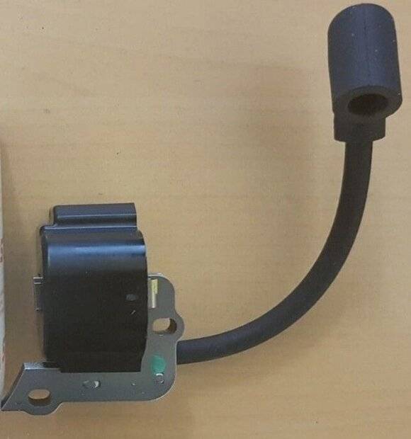

The Stihl HS45 happened to be on my bench at the time, and triggered the question, but as I say above, this system is ubiquitous in my experience. Even on four-stroke mowers, where it must be a waste-spark system. The exact machine didn’t seem relevant, only the description given in my first two posts. I will concede it would have made a starting point for research, though.
There’s a grumpy response to my comment on grumpiness! Built up over a few years of seeing it directed at many posters. Not to be taken personally. Please don’t let us argue about that.
From Jack’s post, I see that the two magnets might be for redundancy, so we could analyse the circuit using only one, for simplicity. That photo looks much like my flywheel - I’ve tried to emphasise the two (doodling on pics is a very Jim Hardy thing to do!)
So it looks like one way to find out the answer is to depot the old coil. It’s a hard, black resin, presumably epoxy. Some say methylene chloride to dissolve, some say heat, some say don’t bother. What’s the best way to do it?

I doubt that Stihl make their own ignition coils, in fact this one is labelled ‘Walbro’ and as I say, is fitted under various names in so much equipment. Someone knows how it’s made, hence the aftermarket version (which was crap, but I’ve got away with aftermarket coils before).
One thing seems certain - I can test the secondary winding for DC resistance between the HT lead and the core. I also built an inductor ringing tester several years ago, with help from JH and the venerable @Tom.G , which may prove useful, at least for comparison:

As far as I could see, both magnets were exactly the same. I think if we ever get to analyse the circuit, we can consider them as one, as per Jack’s earlier post.
So, the magnet(s) passes the first pole at TDC. The first pole is the one with all the gubbins around it. I assume the trigger event is the magnet passing the second pole, a few degrees ATDC.
So, we have a charging event, and a trigger event. Somewhere involved is a capacitor and SCR, as with most other CDI ignition systems. We have all the parts, but not total certainty about how they’re arranged.
Depotting with a heat gun wasn’t ideal - although it made the epoxy crumble, it also melted solder joints and destroyed some components. This may not be very informative, but better than nothing.
Firstly, the transformer part, without the PCB. I’ve guessed the secondary is the right-hand bobbin, from the very thin, numerous windings. The primary appears to be split into several sections, perhaps charge/trigger/?.
Next, the PCB as fitted. You can see the kill terminal, and HT lead connection, with PCB slot:
Finally, some of the components on the other side. Two disappeared, so I’ve marked them in. There’s a TO-92 package marked T, transistor/SCR? And possibly another one above it. I stopped there as I was only doing more damage and making a mess.
Could it be, looking at those diodes, that the charge/trigger events are defined by the direction of flux through the core? At a guess, I’d say the unit is charged as the magnet passes the upper leg, then spark is triggered by the magnet passing the lower leg.
