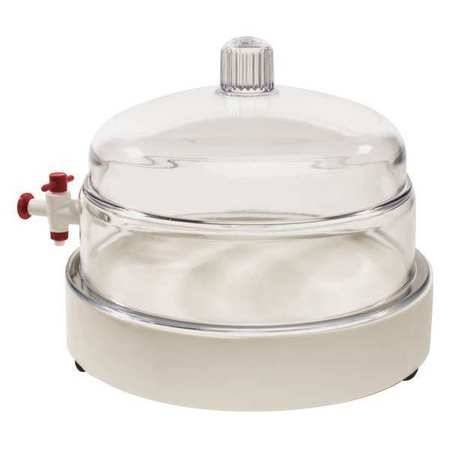

After careful saving, budget finally allowed me to obtain one of these, which arrived two days ago. To my disappointment however, this device is not holding vacuum. I applied Dow high vacuum grease to all joints and both sides of the rubber ring at the halfway point of the container sections, but after a few hours in the freezer, I am losing vacuum. I will point out that, in the original article, the author says to NOT grease the rubber ring/ gasket. Not sure why. Can anyone shed some light as to why I am losing vacuum? Is there any way to tell where exactly the leaks are occurring?

The original article is old. Your device is new.
I would see what the manufacturer of the desiccator you bought says about the issue.
They may also have something like a FAQ or help line where you might get some idea about why it isn't working.
If not the seals, it may have something to do with the valve.
If the manufacturers help doesn't help, there might be appropriate to return it for a replacement.

Here is what the manufacturer says, so I am right in using the grease. I also swapped out valves for a different one, still getting loss. Any way to tell where the leak may be coming from? Can I take the unit from the freezer and tip it in a tub of water?

I could not find any directly useful information on the manufacturer's site, but I did see a different view of the desiccator.
The valve is on slip fitting with the dome. It should slip on and off. It could be leaking and should be greased up (unless you already did).
If that doesn't work, I would disassemble the valve, grease the contacting surfaces, and reassemble.
Sometimes just taking something apart and putting it back together can fix it (dust falls out or ring sits properly).
If that doesn't work go to the company you bought it from and tell they you are disgruntled and want some decent information on a product you bought from them. But do it in a friendly way.
They might be able to provide a useful contact at the manufacturer.

They have a tech manual here. Its mostly about properties of the materials their various products are made of.
Not useful for advice, but among many other things, it will list the resistances to solvents of different plastics. Figure out what your item is made of, look it up, and know what not to expose it to.
It is also a good way to know what products to look for if you want to use particular chemicals.
According to the items webpage it is made of PP/PC; probably polypropylene and polycarbonate parts. These are plastics that can take temperatures high enough to autoclave them (common lab sterilization method (you can do it in a pressure cooker!)). However, they might warp, making them more difficult to use.

Thanks, BillTre, but all may not be lost yet. I just made one discovery which could be causing reading errors. When I placed the desiccator in the freezer after vacuuming, I also placed a simple oil-filled gauge in on top of the removable tray. This internal gauge began to register vacuum drop from about 28 down to 22" Hg over the course of three hours while in the freezer. However, a separate gauge at room temperature coupled to the desiccator valve shows the original 28" Hg. Therefore, the internal gauge might be in error from the cold. Perhaps the oil contracted or even started solidifying thereby affecting the needle. When I bought the gauge, the ambient temp was supposed to be down to -4 F (according to the specs listed at that website). With my freezer bottoming out at around 1 F, it should work but maybe not. I'm going to let the desiccator continue undisturbed in the freezer until tomorrow and see if vacuum changed any on the external gauge before I go any further.
- 5,661
- 4,509
Their tech manual shows the minimum temperature for PP (polypropylene) as -10°C (14°F).
Also check the chemical compatibility table.
But I agree that the oil filled gauge is most likely the problem of the moment.
Edit 1: You might want to check the temperature rating of the guage.
Edit 2: A gauge is oil filled to increase mechanical damping of the needle. Not needed here as the measurand (chamber pressure) is essentially static. Try a gauge based on an Aneroid Barometer:

Thanks for the replies, guys. BillTre and Tom G, you both seem pretty thorough, something I should have been before using the device as intended. However, after roughly 64 hours in the freezer under vacuum, I tested it today using the external gauge and the good news is that there has been very little, if any, change in vacuum (perhaps 0.5" Hg change but not even sure of that). When I was having vacuum retention problems (or just thought I was), one of the first things I did was change out the original flimsy and press-to-fit valve for one of my copper ones I use for my thick walled jars. I had to epoxy a copper tube in place and then coupled the new valve to the tubing with lab vacuum tubing. I was a bit worried about outgassing from the epoxy (JB Weld), but I read it wasn't an issue unless much greater vacuums were used. The plumbing valves can sometimes leak, so I wanted to be sure it was easily replaceable.
This new chamber with valve seems to be holding vacuum better than my thick walled jars with stoppers. I usually have to re-evacuate the latter once or twice a week due to some vacuum loss, but the chamber would not have needed an additional vacuuming so far. So, for now, I consider it ready for use and next week it will have some matter placed within it.
Thanks again for the help and suggestions. Oh, I will be removing the gauge I dropped in there as it will not register properly, but it will be no issue coupling a room temperature gauge as I do with my jars.

After nearly two weeks in the freezer, the vacuum in the chamber has not changed. I now feel confident using it for future projects. I did remove it from the freezer a day ago and the vacuum gauge I placed within it read correct levels once it warmed up. Apparently, the gauges are affected by the cold, so I'll know not to place it within the chamber in the future.
Thanks again for all those helpful suggestions and comments.

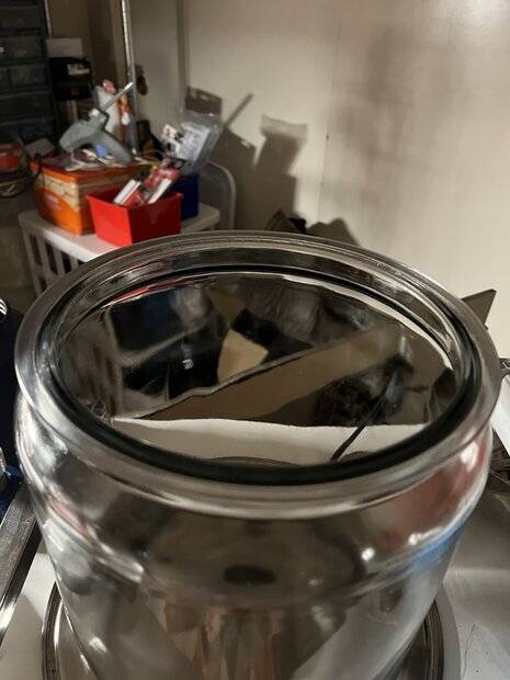

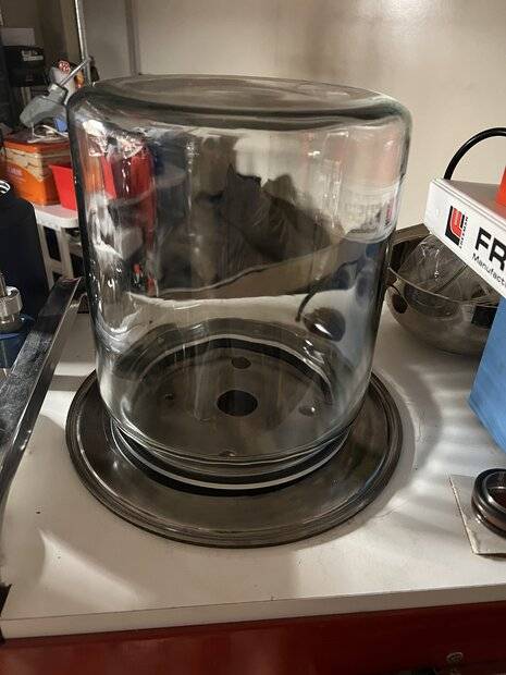

I used a cookie jar purchased from target. I used progressive grades of sandpaper and water and ground the lip of the jar using circular orbiting motions on the sandpaper to even out the surface so to establish a tight seal for a good vacuum. The photo shows the setup I am still working on to do Vacuum deposition experiments etc. When I am ready I will build a protective screen shroud around the glass in case of implosion protection. Will be interesting to see how much vacuum a glass cookie jar can withstand.
The images show the lip of the jar with a 1/4inch surface ground flat and the overall size over the nickel plated steel plate. Height of the jar is about 10 1/2inches and the diameter is about 9 inches in diameter.

A glass jar will be structurally stronger under a positive external pressure, than it is under internal positive pressure. An internal vacuum is equivalent to an external positive pressure, and is limited to atmospheric pressure of about 14.7 psi.Ducatidragon916 said:When I am ready I will build a protective screen shroud around the glass in case of implosion protection. Will be interesting to see how much vacuum a glass cookie jar can withstand.
A normal vacuum is as dangerous as a high vacuum, the high vacuum just has less contamination.
The danger of a vacuum is primarily for things inside the chamber, things that will be cut or crushed, by the imploding walls, or the incoming atmosphere.
The external danger of an internal vacuum is the projectile fragments that accelerate through the container, bounce off the contents, or pass through the opposite wall. One lethal example is the electron-gun in the neck of a cathode ray tube, that was aimed at the operator's head, who was watching the screen.
