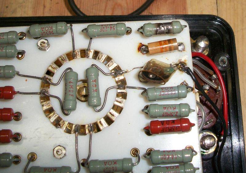

Most of the meters i run across are of voltage measuring type not current as in your example.
When somebody accidentally connects that type ohmmeter across 120 vac housepower while selected to RX1 , it smokes the internal halfscale resistor . Manufacturer often intends it as a fuse, they're usually metal film.
You can buy such meters at thrift stores very cheap . The telltale is they read full scale when connected to even a 100 ohm resistor or flashlight bulb. That's why they were junked. It also tellls you the meter movement at least moves and isn't burnt open. Open them up and look on the circuit board, you'll see a charred Rhalfscale.
It'll look something like this, top right:
Now you know how to figure out what resistor to buy to fix a bargain junkshop meter.
