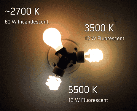

The purpose is to let people know what color the light will be when they turn it on. That way if I go to the store and buy a 5500 k bulb, I know it will be "white", or if I buy a 2700 k bulb I know it will be "orangeish".
See below:
Photo of three ceiling-mounted light bulbs in one fixture: a glowing incandescent bulb labelled ~2700 K, 60 W Incandescent, and two spiral fluorescent bulbs labelled 3500 K and 5500 K, each 13 W Fluorescent.
okay, so i calculated the corresponding wavelength for the 5500K, and it was near the green meaning all the colors would be mixed almost evenly giving a white color. however, i calculated the corresponding wavelength for the 2700K, and i got 1074 nm which is definitely in the infrared spectrum, and the graph of the color distribution falls off pretty rapidly as you move to the left from the peak wavelength, which seems like the color should be a lot redder than the color of the 2700K in the picture. 3500K corresponds to 828nm which is still on the IR side! hmm.. everything seems to be shifted to the right of where the peak wavelengths are...
Not true. A 5500 k object has a spectrum with a significant difference in radiation towards the blue and red ends. But our eyes are "calibrated" to see this as white still. (We actually see "white" over a wide range of conditions)
Consider that metal glows cherry red at around 1,000 k and distinctly orange at around 1500 k. By 2,000 k objects are yellowish-white.
