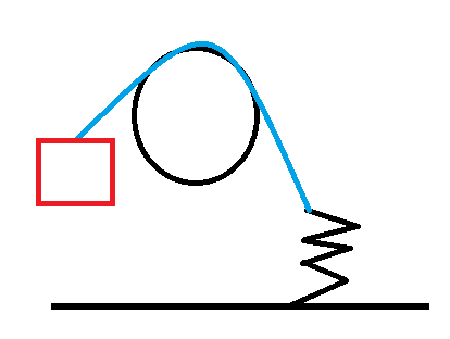

A wheel with moment of inertia I. A mass of M is connected to a belt and runs over the wheel with radius R and connected to a spring with a stiffness of k which is connected to the ground.
Show that if the mass is pulled down with a force of F and released the system will oscillate with SHM with a frequency
f=1/2pi sqrt k/(M+I/R^2)

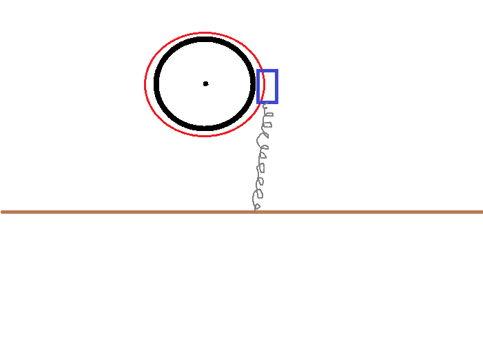

I'm also having trouble interpreting the situation though. The description above isn't giving me a good visualization of how everything's connected.
Oh no, x is the displacement =P sorry about that.
Are we looking at something like this?

Im not sure how to incorporate the inertia or work it out.
Oh, I like your picture better. I thought the block was attached to the spring and it wasn't making sense.
Start out just like you did in your notes. Start with N2L, and this time incorporate the wheel.

Well first thing, Torque = R x F, not F x R.
Second thing, either your prof skipped a step when solving for ma or you didn't write it down. I haven't gotten through the whole procedure yet, but let's take it step by step, cool?
You know the sum of the forces on the block = mass of the block x acceleration of the block or sum(F) = ma, and therefore sum(F)/m = a.
What is the sum of the forces on the block? Keep in mind, throughout the whole system, there are 5 forces to be accounted for (not all of them DIRECTLY on the block, though). Hopefully that was a good enough hint as to clue you into what we're looking for here.
I can only think of 3 forces, and I think that is all I need for work at this level.
The force of the spring
Torque inertia of the wheel
And inertia force
Is this correct?
Yes that will work, I thought about it, and what you've got going on so far seems reasonable. I did it another way, which included tensions and weight, but they ended up dropping out anyways.
So let me ask you a question. Is there a particular aspect to this problem that you're getting lost in? Or is it just the method in general?
I think I may have cracked this
Total force to pull down = torque inertia of wheel + spring force + inertia force
