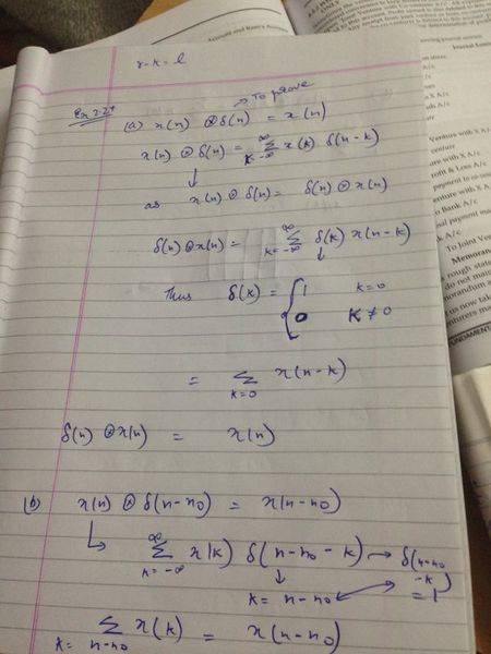

I have given the question and my attempt in the image that i have loaded please tell me that am i doing it right ?
  • Handwritten notebook page working through convolution identities for discrete signals: proof that x(n) convolved with delta(n) equals x(n), and x(n) convolved with delta(n-n0) equals x(n-n0), with summation steps.
rude man said:
I would if I could read it ...
I have added a new image
  • Handwritten proof on paper that x(n) convolved with delta(n) equals x(n), using commutativity, the sum over k of delta(k)x(n-k) with delta(k) equal to 1 at k=0 and 0 otherwise, giving x(n).
