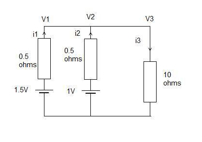

simple circuit analysis -- can someone check if it's right?
(circuit can be found on http://www.MailFreeOnline.com/uploader/A723E91C.jpg )
i. write down equations relating i1 and v1, i2 and v2 and i3 and v3
ii. solve for the voltages v1, v2 and v3
iii. determine the currents i1, i2 and i3
KVL
KCL
i.
i1 = 3 - V2
i2 = 2 - 2V2
i3 = V3/10
ii.
i1 + i2 = i3
3 - 2V1 + 2 - 2V2 = V3/10
therefore 5 - 2(V1 + V2) = V3/10
iii.
(this is the hard part for me. have i used KVL right?)
first window:
-1.5 + 1 + V1 + V2 = 0
therefore v1 + v2 = 0.5
second window:
-1 + V2 + v3 = 0
therefore V2 + v3 = 1
overall window:
V1 + V2 + V3 = 1.5

i1 = 3 - V2
i2 = 2 - 2V2
i3 = V3/10
Think about what you did for I1 and I2, the left side of the equation is in the units of Ampere, and the right side of the equation is in the units of Voltage.
Stick with Ohm's Law to find I1 and I2, similar to what you did for I3
huh? isn't i1 = (1.5 - V1)/0.5, for example?
You're right, sorry about that.
So how did you get I1 = 3 - V2? Solving it your way, wouldn't it be 3 - 2V1?

Looking at your steps, it looks like you're doing okay. But somehow I can't agree with you that V1 + V2 + V3 = 1.5. I don't think you can combine it like that. I want to say that V1 = V2 = V3 because they're the same node.
(but then your equation V1 + V2 = 0.5 and V2 + V3 = 1 no longer makes sense...)

Perhaps redrawing the circuit will help you.

ah i see what you mean now. so where did i go wrong? i thought my KVL logic was correct...
also, isn't it true that i1 + i2 = i3? if you plug in my values, you get something else.
I vaguely remember the windows separation method, like what you did. But I think you're supposed to follow the path of the current, so you can't do something like
-1.5 + V1 + V2 + 1 = 0
Instead, you're supposed to go to R3,
-1.5 + V1 + V3 = 0
It's been a while since I've done it, so maybe? heheh.. but if you look at the circuit I came up with, it should be more clear.

if you substitute in my (supposedly correct) equations for i1, i2 and i3, you don't reach the conclusion that V1 = V2 = V3...
also, using the window method, I'm sure you can inspect every window individuall. i just don't know how to do it lol.
I do believe the right way to solve this is to assume that V1 = V2 = V3. Let's look at the windows of the final circuit I drew then.
I1 = (Vs1 - V3) / R1
I2 = (Vs2 - V3) / R2
But we also know that V3 = I3 * R3 by Ohm's Law.
By KCL, we know that I3 = I1 + I2.
V3 = (I1 + I2) * R3 and plug in I1 and I2 from above, and you should have V3, which is equals to V1 and V2. From there you should be able to solve for I1 and I2.
