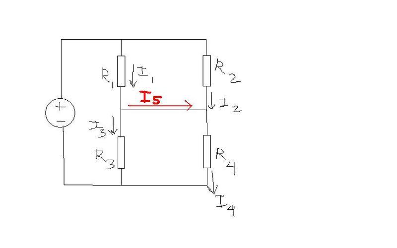

In the attached circuit diagram, I have found the values of everything except I5 (shown with the red arrow).
Applying Kirchoff's Current Law to the intersection of R1 and R3 came to mind, but then I saw that I5 itself is on a node! If I applied KCL at this node, the equation would come out as I1 + I2 = I3 + I4 which does not do anything for I5.
Or is it valid to apply KCL at the intersection of R1 and R3, and say I1 = I3 + I5?

Yes you can write two equations for that point.
[tex]I_1 -I_3 -I_5 = 0[/tex] and [tex]I_2 +I_5 -I_4 = 0[/tex]
When thinking of applying KCL you should think of it as what it states basically, what the idea is and then see wether you can apply it.
Now, the idea is: Take some point in your circuit (can be a node, doesn't have to be) and all currents coming from one side mus proceed/ leave to the other side. All currents going in must go out, there can be no loss of current. When applying you then choose one direction as the + direction (for example leaving the point) and the other one is then the - direction. The currents then get -/+ signs and when adding them up you get zero. Of course you can rearrange things in the way proposed by Corneo.
You can easily see that Kirchhoff works well for your problem.

On the 2nd question, I also would have suggested KCL equations exactly as Corneo did, which follows from the direction of currents indicated in your circuit diagram.
