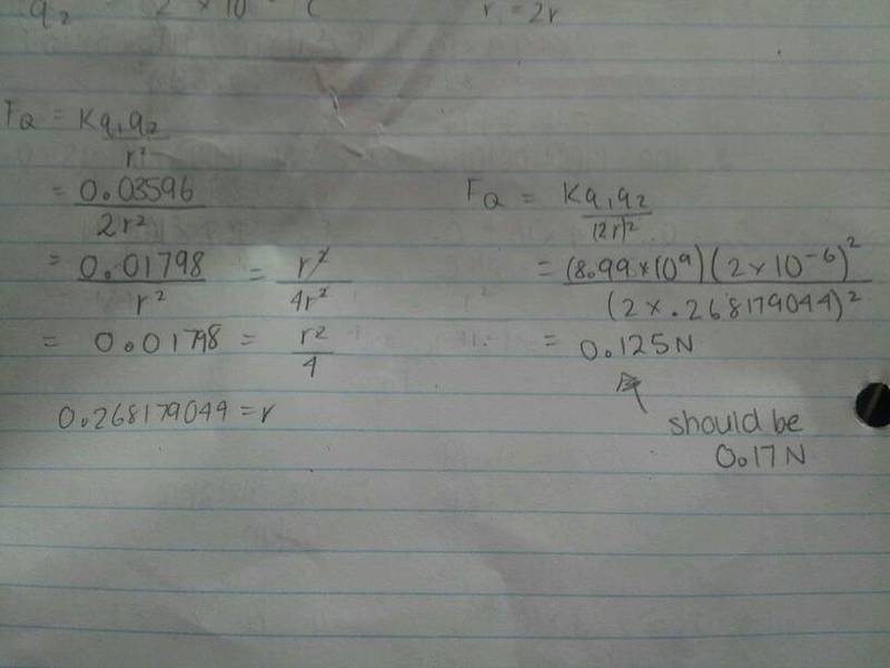

hey sorry, but I'm still not getting the right answer for some reason, here's my solution (see picture)

nevermind, I realized my method was wrong and got the answer. Thanks again!
p.ella said:
aorry I just realized I never canceled out the r^2...is my method correct though?
It's simpler if you just pay attention to what changes. That's the ratio and proportion trick. k and r^2 and μC and all the other units don't change. Divide the two forces by each other and they all cancel. All that changes is (-6)(2) becomes (2)(2) and you get a 1/4 factor from the change in r. What's the ratio of the two forces?
