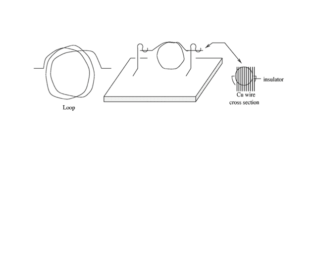

Hello ! I'm making a simple electric motor. Using copper wires and 1.5V battery.
2 magnets, 2 thumbtacks, 1 block of wood, 2 paper clips, and approximately 2m of insulated copper wire.
-The diameter of the loop must be 1"
CAN'T use other materials, only the above listed.
I just want to ask what do I need to do to have 1500 RPM or more.. Thanks!
-Maybe the setup/orientation will be a factor.
-See the uploaded file.

Hi sharm8, thank you for the diagram
For maximum speed I think you should aim to minaturize it, and make the rotating part as symmetrical and evenly balanced as you can. Use strong magnets, and a large sized battery. The big cells (D cells or bigger) are still only 1.5 volts but they can supply more current. If your copper wire is thin, perhaps run two strands together as one so it acts as though it is thicker copper.
You'll have no idea how fast it will spin, you just have to construct it using good techniques, then run it and see how it turns out.
Post a photo when you have it working.
Good luck!

A speed of 1500 RPM is pretty ambitious. You should set your sights on getting the motor to turn.
At a speed of 1500 RPM, a motor fabricated by hand is going to have a lot of imbalance in the rotor. Even if you were to achieve this speed, the motor would probably destroy itself due to vibration in short order.

Thanks for your advice, it will be a big help! :D
I think I will be using subwoofer magnet.
Thanks again, I will update you as soon as I finished it :D

Wear safety glasses when you're testing it it!
The strength of the magnets changes the efficiency of the motor (and that might be a factor here) but in general stronger magnets make the no load speed slower. The motor will accelerate from rest until the back emf equals the applied voltage. If you increase the strength of the magnets the back emf increases so it matches the applied voltage at a lower rpm. Best experiment with different magnets.

the problem with 1500RPM is: with the limited materials you are allowed to use even if you use a near perfectly turned center piece to coil on you only have paper clips and thumbtacks to hold it in place while it spins neither of which will make a solid or even balanced axle.
