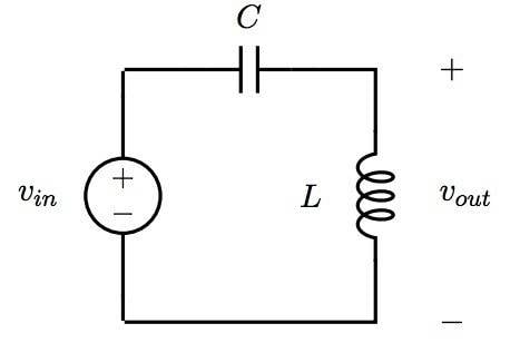

Find a differential equation that describes the circuit that includes only vin and vout as variables.
C(dvin - dvout)/dt = i
vin - vout = L(di/dt)
So the answer I got was:
C(d2vout/dt2) + vout = LC(d2vin/dt2)
My question is, is it allowable to break up the capacitor derivate like that? After substituting in for i, I got:
vout = Ld/dt(C(dvin - dvout)/dt)
Then I broke up the capacitor into vin and vout terms and just rearranged. But I'm not 100% sure if that's legal.
That first C should be LC.
A rule of the Calculus says that the derivative of a sum equals the sum of the separate derivatives, so your approach is correct.
Woopsie, right. LC
Ok sweet, thanks. I just can't remember something we might have glossed over a few years ago . . . and no one recently has said "You can do this to a derivative". They just sort of do it on their own.
