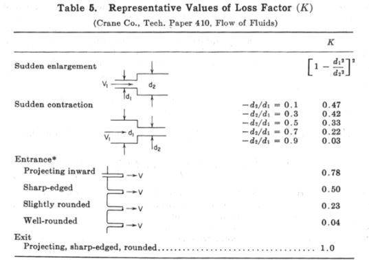

I need to set the discharge coefficient to 2.3 (found by experimentation), and then I get a result very close to 1m30sec to get below 1000kPa. I also see the mass flow rate decrease, but i am currently unable to plot the data. I only have this one example to compare with so I don't know if my model works for other initial conditions.
I recommend you use "Cd" because this applies directly to the efficiency of the nozzle bore; whereas, "K" is a factor for addressing the effects of the shape at the nozzle entry and pipe inlet size ratio vs the pipe size at the nozzle exit as shown below:
The maximum value for Cd is 1.00 so adjust your nozzle bore area to result in a venting time a bit longer than your target time and then adjust the nozzle flow down to achieve you target venting time using the nozzle Cd coefficient.
For a quick reference on nozzles and nozzle coefficients, including K vs Cd see:
https://neutrium.net/fluid_flow/discharge-coefficient-for-nozzles-and-orifices/
