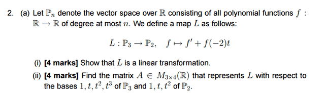

Here is the question, i know how to do part (i) but I do not understand part (ii):
[/B]

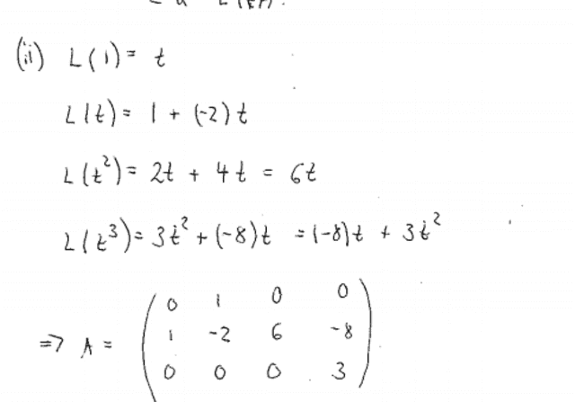

here's the solution from the marking scheme:
i understand how they formed the matrix from their working out (i can se the pattern), but I do not understand the actual working out. Thanks to anyone who could explain it to me.
why does L(1) = t? why does L(t) = 1 + (-2)t? etc
[/B]

If f is a function in P3, then L(f) = f' + t * f(-2). In other words, to get the image of a function f, add the derivative of the function and t times f(-2). So L(1) = 0 + t = t. Can you figure out why L(t) = 1 - 2t?

L(1) = 1' + 1*(-2)t = d(1)/dt + (-2)t =
0 + (-2)t = (-2)t
=/= t.
what is f(-2) equal to anyway?

Indeed !
What is ƒ(-2) equal to?
What is ƒ ?
You were considering finding L(1) .
That makes ƒ(x) = 1, a constant function, so it maps everything to 1. It even maps -2 to 1.

I think i understand.
L(1) means that we are considering the function f(x) = 1 (a straight line through y=1):
L(f) = f' + f(-2)t
L(1) = d(1)/dt + f(-2)t
f(-2) is equal to 1 in this case, so:
d(1)/dt + f(-2)t = 0 +t = tHowever, if we consider L(t):
L(t) = t' + f(-2)t
=d(t)/dt + f(-2)t
= 1 + f(-2)t
in this case, we are considering f(x) = t, another constant function (y=t throughout), so f(-2) = t:
L(t) = 1 + f(-2)t = 1 + t*t
= 1 + t^2
this does not equal 1+(-2)t as indicated in the markscheme.EDIT: nvm, i understand now.
if f(t) = t then:
f(-2) = -2.
Plug it all in and it all works.

SammyS said:
In my previous post, I should have used t as the independent variable, not x. (It would have been clearer.)
So here: For L(t),
That means ƒ(t) = t . (That's the same as saying ƒ(x) = x .
Function, ƒ , is the identity function, not a constant function.
ƒ '(t) = 1 . ƒ(-2) = -2
