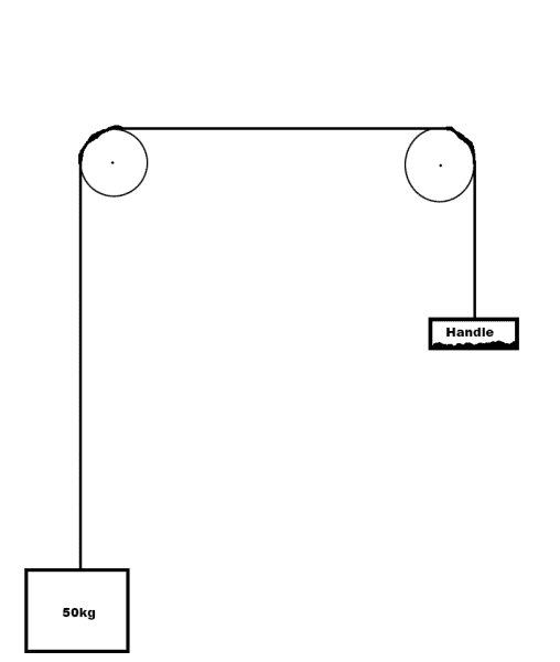

Hi,
I am building a simple pulley for a weightlifting machine. In most cases pulleys are designed to lift heavier loads easier, I want to actually make it harder to lift the load… So I don't have to put so much weight on the end.
Can I amend my simple pulley design in a (simple) way to increase the force required to lift the load at the end?
In my example I want to lift the 50kg load… How would I make it double the load, so it feels like I am lifting 100kg?

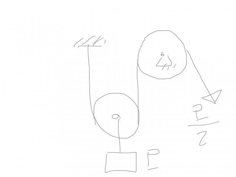

Look at schemes that make a weight easier to lift and interchange the person pulling with the weight being lifted.
For example, end of rope attached to ceiling. Rope goes under a movable pulley attached to pull-handle and then over a pulley attached to the ceiling and then to a weight attached to the other end of the rope.
For instance, look at the drawing
Thank-you very much for your replies. Have got a few ideas in mind now about how to make it work.
