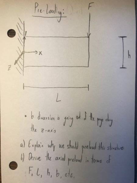

Hello, everyone.I have been trying to understand the meaning of the question from the posted image.I think that preloading has to do with adding bolts to the cantilever beam such that it can withstand the force from above, but I am not sure how exactly these bolts should be implemented.I would also like to generate a meaningful equation based on the information provided.

Preload means to put a preload force where F is to load the structure even before F is applied.
What purpose would this serve? Wouldn't it just reduce the amount of overall force required to make the beam fail?
I think the preload should be in the opposite direction to F.
For example let's say F varies from 0 to 10kN. If you add a preload of -5kN then the net force varies from -5kN to +5kN. That helps if the strength is symmetrical.
I think!
Edit: I've had another look at the question, and I think it's probably more complicated than I have assumed. So I'm probably wrong.
Could this be an axial load in the direction -ve x in order to prevent tension developing at top left corner?
