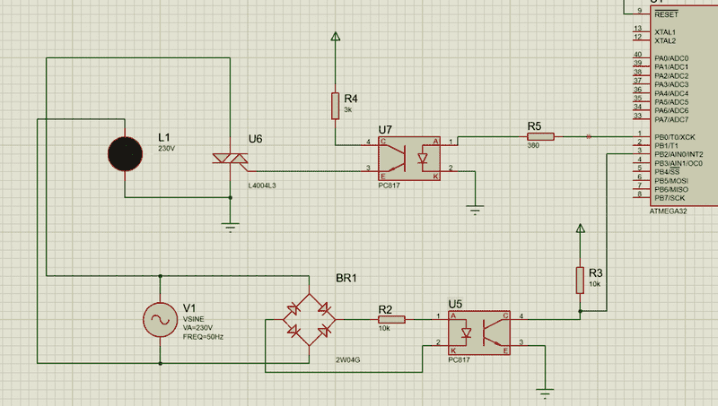

Guys, I tried building the circuit, here's the schematic:
So bascially, the bottom optocoupler (U5) is the zero cross detector which will send a pulse to pin 3 when a zero is detected and fire an interrupt. This interrupt will trigger a timer which will fire the second optocoupler(U7) when the timer has elapsed (Brightness level will determine the time delay)
Now for my question, I want to know if I connected everything fine before I start the coding, especially the triac part, I am unsure about that

The light needs to be in series with the triac... :smile:
As I read this, the triac is in series with the bulb.
I would point out that you could build this using a stepdown transformer first, and run this around 12 vac, to test it. Of course you need a low voltage bulb.
You can then test each section out easier, and less risk of blowing something up.
Fuse that source!
I am a little curious if the rectified portion of the zero crossing signal will go completely to 0v, also in this set up the zero cross signal to the uC will be normally high, and you will turn off at the 0 ceross. Probably will...
Ah, you're right. The "ground" symbol between the triac and the light confused me. The ground symbol needs to be removed, especially if it is meant to be the same as the ground symbol shown on the SELV side of the optos.
Actually, what you need to do is be sure that the opto pullup voltage and the "ground" for the triac are different symbols from the SELV versions. I see now that you want a reference voltage for the triac trigger, which is fine. I think I would reference it to Neutral as a low-side switch, though... How are you making the opto pullup voltage for the triac?

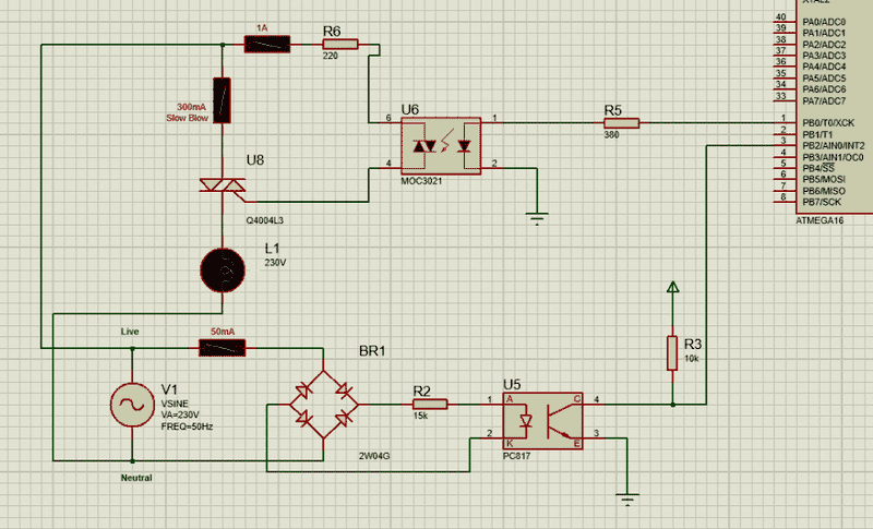

I modified the circuit to this,

I'm having trouble choosing R6 though, in the datasheet for the triac (L4004L3), this one
http://www.littelfuse.com/~/media/f...es/documents/data sheets/e1sensitivetriac.pdf
Igt = 3mA, so if I calculated the resistor value for peak voltage and 30mA current
R = Vpeak/I = 230/30mA = About 8k
But now let's say the triac is triggered when the AC voltage is 10V
I = V/R = 10/8k = 1.25mA
But since Igt is 3mA, the triac won't turn on
If I try choosing higher currents, the resistor power increases
Right now it's sitting at
P = I^2 * R = 0.03^2 * 8k = 7.2W peak power
Pin 3 for most of the cycle will be low, but around the zero crossings it will go high.
For resistor power dissipation, don't overlook the fact that once the triac is ON the voltage across it (and across that gate resistor) drops to just a few volts.
In practice, these circuits incorporate RC filtering to reduce false triggering caused by electrical noise, e.g., http://www.bristolwatch.com/ele/triacs2.htm

Thanks guys, I now added some fuses and changed R6 to 220ohms, I now have this circuit
Need some help with the fuse current rating, this is how I calculated it
Since the PC817 can take a maximum current through the LED of 50mA, I used a 50mA fuse.
Then I checked the triac and it says "surge capability up to 55A" http://www.littelfuse.com/products/switching-thyristors/triac/lxx04xx-qxx04xx/q4004l3.aspx
The moc3021 can take max 1.2A
So my total current(peak) = Current drawn by bulb + current drawn by moc3021
= 60W/230V + 230V/220ohm
= 0.26A + 1.05A
= 1.31A
So maybe 1.4A, 1.5A fuse ?
And what type resistors should I be using ?, thick film ones ?
And, do I need a snubber between the triac ?

i think my one inch suggestion was way overboard. Some of our equipment used resistors that big to protect against 480 volts...
http://www.vishay.com/docs/28737/nfr25.pdf
http://www.vishay.com/docs/31031/cmffuse.pdf
The fuses you picked should do admirably.
R2 protects U5, R6 protects U6...
Incandescent lamps draw a lot of inrush current so either pick a slow-blow or test for a faster one that reliably lights the lamp when you start it at full brightness. Typical inrush is about 10X normal.

Thanks jim
I now basically put 3 fuses (those black boxes). I read about slow blow fuses and they basically allow a high inrush current for a small period of time before blowing. Since the bulbs normal peak current is I = P/V = 60W/230 = 260mA, I put a 300mA slow blow to allow the inrush current which is about 3.64A (14*normal)
The 1A fuse is for protecting U6
The 50mA is for U5, since 50mA is the LED's max current
Not too sure, what do you think ?, is it fine ?
Not too sure if they even have fuses with those current ratings, I googled a few and they did come up though

It's thorough.
Myself i'd loosen up a little
use a single 1 amp to protect both U8 and the lamp socket, rely on R6 to fuse if it needs to save U6.
Old technician's saying: "Semiconductors are great fuse protectors. "
There's no inrush to your bridge so a good fast acting fuse will work.
I'd rely on R2 to protect U5 and pick a fuse that protects BR1. He looks to be a 2 amp bridge, and you need only a fraction of that
AGC is a common fast acting fuse available in 1/16 amp . I think that'd be sensible.
I do like that you placed your triac in the high side line.
When it's placed in the neutral,
that leaves this part of the socket and lamp "hot" when off and it's an invitation to get shocked changing a lightbulb that you think is switched off.

I'd go for a 2A fuse if that's still well within the triac's rating. The semiconductors will probably melt well before the fuse; anyway. You don't want the fuse element to be thermal cycling every time you use the equipment or it will slowly degrade. And sooner or later the bulb will blow or get broken and the nearest replacement on hand will be a higher wattage than you'd originally planned.
