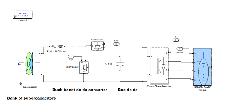

I want design in simulink a model of hybrid vehicle.
As for the parameters, i mean values in blocs.
I'm not familiar with Simulink, but I have worked with some other simulators. What is your level of expertise with Simulink? If you are asking us to do your schoolwork project for you, that's not going to happen (see the PF rules). If you have some experience with Simulink and are having trouble with specialized models, please tell us what type of models Simulink uses (FEA, State Space, other?), and post your initial attempts at modeling these components and systems.
I'm a beginner with Simulink. my level of expertise with Simulink is: initiation. No, I do not ask to make my project for me. I have difficulties, sizing blocks cobstituant my global system. I can send you figures of the block in question. for the experience with Simulink I have some and I have problems with sub models. which are retrieved as blocks from the simulink library. the type of Simulink models currently being used by simpowersystems. ok I will publish my first attempts to model these components and systems. Cordially.
it is my model.

the electric motor (PMSM) data are:
number of phases: 3;
Stator phase resistance Rs (ohm): 0.091;
Inductances (Henry) [Ld (H) Lq (H)]: [0.001597972349731, 0.002057052250467];
Linkage flux (Weber): 0.175666143629361;

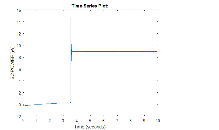

I did the simulation and I noticed the power of the pack of supercapacitors.
here is the figure.
Well we can not measure the power of the pmsm because it is not loaded.
So I'm going to connect him to a vehicle model.
