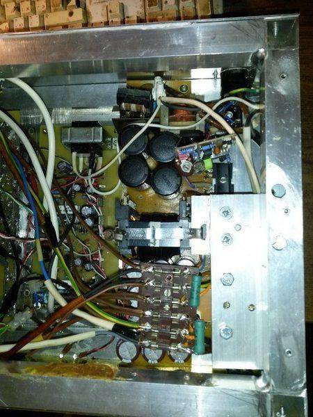

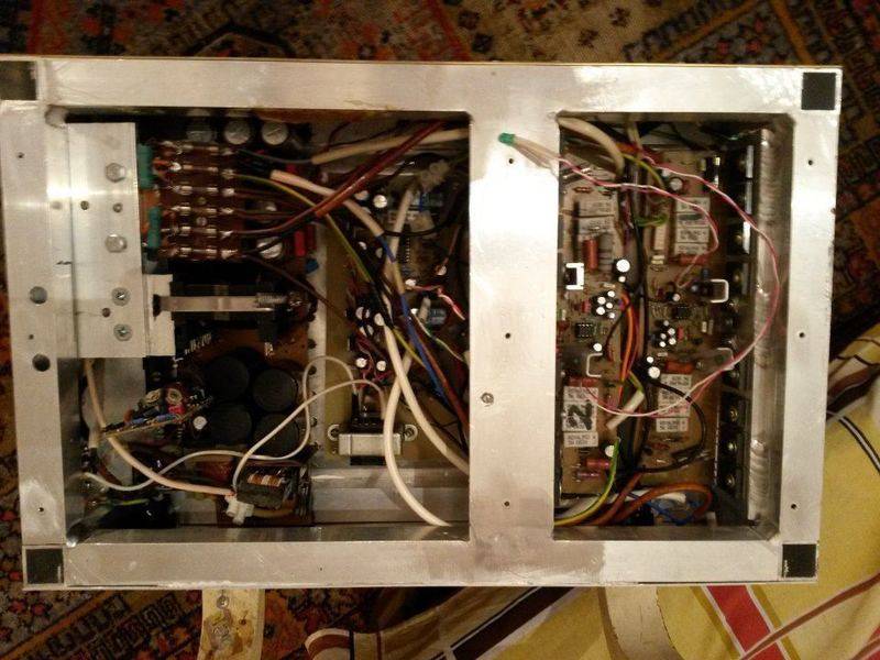

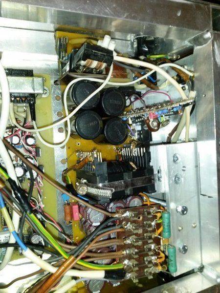

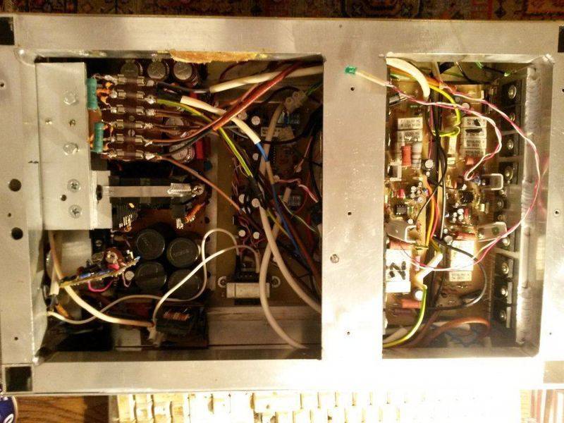

Ok, I'm back , here are some observations , maybe i will go into more detail later as this is the last day with high heat here and when temperatures are lower my head works better.
I rewound the bobbin.I put some 15 turns of primary instead of 16 as 15 turns matches an even number of secondary turns for the voltage I need , since it's rather messy to have say 17 turns of secondary which produces overvoltage or 16 which in my case would produce under voltage in case of a 16 turn primary.
So I put 15 on primary and 16 on secondary.
My observations are as follows , I'll start with the less dramatic ones.As awkward as it may seem but for the same loads it feels like my smps aluminum heatsink block is warmer than it was with the 11 turn primary.So it must waste more heat now. Atleast the volt turns are following some logic I put 15 turns on primary so it goes like 162/15=10.8 , so I should get about 10 volts per turn in the secondary winding.Which I get.
The ferrite core is still quite warm , there has been maybe a small improvement and the core isn't hot by touch anymore but it's temp is still i'd say some 50/60 degrees celsius.The savior for this is the fact that the core sits tightly to the common aluminum heatsink and so the heat slowly drifts away.
my whole box is one big aluminum heat sink so that kind of helps set matters evenly.
I will have to do some research more into this as the turns ration and core material might not be the only ones to blame
I did a test earlier with the 15 turn primary today I took out the fuses that connect my dc output rails from psu to my amp boards and simply connected a dummy load for test purposes which consisted of a water heater and a halogen lamp in parallel , for the output voltage of 160v DC the power i calculated from ohms law was somewhere around 300/400w I can't know for sure since the filament of the 200w bulb changes it's resistance upon heating up.
The core and the smps heat sink were warm with the core being a bit hot but still ok.
Now I connected back the fuses and listened to some music for some 30 mins maybe bit less and to my surprise the heat sink was almost as warm as with the previous dummy load , and the speakers were quite small and i was running only two out of 4 channels , the other two disconnected channels had warm heatsinks too which tells me that the idle currents are maybe higher than they need to be.
So maybe the core is also getting hot because the amplifier has 4 x500w boards with idle currents running and the smps output has 2x 15kOhm resistors as maximum idle voltage limiters etc , in other words it wastes quite some power even with light music loads.
Anyway the situation is better but not as good as your calculations showed , definitely not a 30% or so gain.
And the heatsink seems warmer now which I can't understand , maybe the ferrite core is better pushed to the heatsink now and causes the elevated temp, I'm not sure.I have added some pics just in case you Jim want to see my far from perfect and far from ideal home made magic box :D
Even though the wiring seems messy when I connected all the grounds in all the right places I miraculously have no hum or background noise in the output.
the amplifier boards are at the left side , in the middle there is the protection board and at the right side there is the smps unit.the pics are rather bad but i hope you are able to see the stuff and how its put.
Have you understood yet that flux depends on voltage across the windings not load current through them ?
So if it's flux the core should run same temperature loaded or unloiaded.
SMPS cores lose less heat as they warm up note 25C and 100C curves on the graph
and is this a metal loop as Tom.G asked?
Is the core pressed hard against aluminum ? I can't tell.
If so you might well be making eddy currents in the aluminum heating it right where core touches it. To test for flux fringing superglue a penny or piece of timfoil on top of the core and see if it gets hot. Beware , don't let it fall across something dangerous.

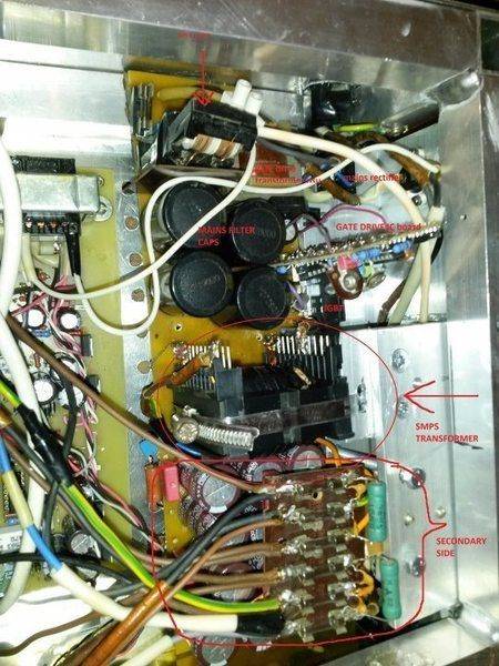

since i don't have a separate transformer picture here is how the transformer looks without being wound.exactly like the one I have.the water heater is not that big , it's about 1000w if I'm correct , but that's for 230v since I am attaching it to my smps output which without the middle tap is 160v DC so it runs with lower power.
Yes i now start to see the difference between flux and power delivered through a core.
Although I must say most of the heat comes from the flux probably since the heating effects with various loads change only minimally.
Another observation I have made is that many mains transformers run rather hot also , and also in their core not the windings.
I have this same thing going on in a Onkyo Integra m5060r , I repaired the thing and it works and all is well , but I put some LED orange warm lights in the place of the original burnt out bulbs for the front panel and after some 5 hours of listening the mains transformer cores are rather hot.
But since the listening happens on very low levels I assume the cores heated up gradually but I don't suspect pure flux to be the reason after all they are factory made things.P.S. Yes the hum thing was rather strange , I got this weird HF noise in two of the 4 channels I had but then i built the other two put all of them in wired the ground connections to the best of my knowledge of avoiding hum nd noises and now the noise is gone , it's quite weird given the fact that this was high frequency noise coming a bit through inductance via air and mostly in the form of ripple which was not filtered out in the DC smps output (even with my decent sized filter bank and snubbers) but now t's not there anymore yet I haven't changed a thing , so it's balancing on the edge with magic.I bet I could attache my scope and I would still see some small ripple on the DC bus voltage.PS 2, maybe I should try out @Baluncore idea of making a small airgap in the core although I read that it could only make the magnetizing curve less steep and not prevent saturation if it happened although I assume if the curve is less vertical then saturation point also moves further in time.Yet I'm not sure if saturation happens there since I haven't put any scope probes into the primary yet.

okay now i see your transformer
if that hose clamp doesn't get hot you're okay on the external loop i think
don't worry about the core running hot to the touch did you see that note in the TDK info ?
Heating up
Ferrites can run hot during operation at higher flux densities and higher frequencies.
i'd say 1970 mt was high flux , from those curves
and anything over 140F is scalding , to my touch

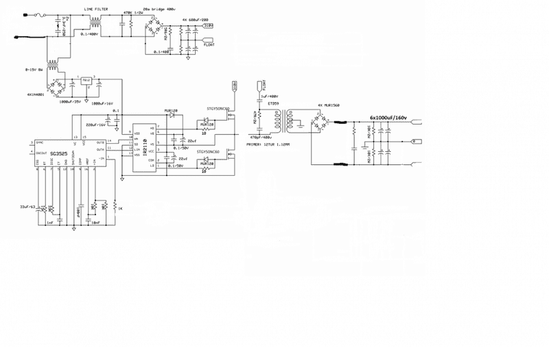

I will attach the schematic of the smps.
what do you think could the extra 3 turns since I have 15 for primary now cause extra losses in the switching IGBT's ?
could it be that with extra turns I'm running tiny bit of purely resistive losses on each cycle through the primary while with the lower turns I wasn't?

Just off the top of my head, that COULD be because the added turns changed the resonant (ringing) frequency of the transformer. It is possible that the original ringing frequency just happened to result in zero-voltage or zero-current switching and now it has moved off that sweet spot.
Another possibility is the snubber capacitance is too small for the increased inductance, try increasing its value to 1.9 times the current value.
well i thought too about the zero volts and current switching , well i'll do some more testing and see because if the core temps don't change much i'd rather keep losses lower and semiconductors cooler , let the ferrite heat the room if he wants so desperately :D
Ok so I separated the transformer core from the common heatsink and the heatsink isn't warm anymore so it was made warmer by the transformer core giving off it's heat to the heatsink , although I don't worry about this since the heat sink is rather big with reserve and it is attached to the aluminum cover plate once the plate is put on.
Yes the core runs hot but not as hot as to cause any danger , simply hot.Strange but seems it's way things are.
I think I will simply take a deeper breath for now and let things run for a while and then see how it goes with various loads and lengths of time and then tell some more if there is anything new.
As you Jim said, seems like the core heat develops after some amount of time pretty much irrespective of the load If I switch it on and listen to some louder music it doesn't get as hot as if I simply switch it on and let it sit there for a longer time.
