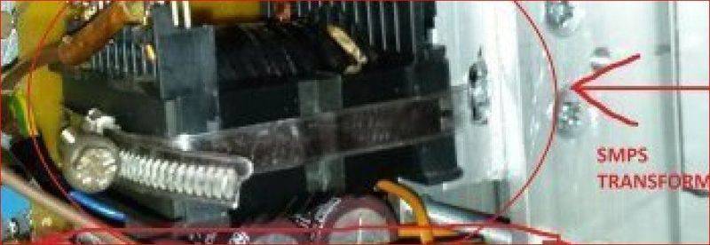

So after some trial and error I've built a working smps for my amplifier , it's pretty high power ,when testing dummy loads i got up to 2KW , since I don't need more for my project I never went further as I had no need.
It's not regulated but it dropped some 15 volts at max dummy load so works for me.
The problem is this , after trying out some leftover ferrite cores simply to understand that there's no luck with them I bought a new EPCOS made core.It's the ETD59 , the material is N87 with permeability of 5300nH.
the size of the core is 59.8 x 31.2 x 22.1mm
Based on other smps using the same materials I made 12 turns in the primary (maybe 11 can't remember)
And the secondary even though doesn't play a role in this problem is some 2x7 turns.the primary is wound with some thick litz wire salvaged from some old smps.Haven't exactly measured but I would say some 3 mm2.
the transformer frequency is +- 50 Khz, driven by a pair of half bridge IGBT'S. The problem is this , under load the core heats up , I kind of predicted this so I made my heatsink such that it also touches the core , in other words I have an aluminum box with large surface areas and everything is thermocoupled to the box.
But still I think the core gets too hot even with lighter loads , something probably isn't right.The windings themselves stay cool , only slightly warm but then it could also be the effect from the heat given off by the core.
When I was younger i made a few mains transformers with hand and I once got my turns calculations for the primary wrong and ended up winding fewer than necessary turns , but back then the windings got warm not the core , since there wasn't enough inductance and the wires went through some resistive/ohmic heating on each mains cycle.
So I wonder what could be the problem , my own guess is too few or too many turns in the primary, rather too few but I'm not sure.

... , under load the core heats up , I kind of predicted this so I made my heatsink such that it also touches the core, ...
A heatsink on a ceramic core will likely fracture the core due to differential thermal expansion between the hot and cooled regions. Cracks in the core will reduce both thermal and magnetic conductivity. You are better to cool the entire transformer in free or forced air.

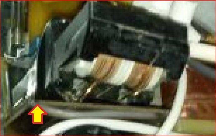

Have you considered the possibility of there being a shorted turn somewhere in your metalwork ?
What do you mean by shorted turn in my metalwork? If you think a shorted turn in either the primary or secondary winding , then no because given such few turns I would immediately notice the difference in output voltage.
Output voltage hasn't changed since the first day I wound this particular transformer.
thanks for the link @anorlunda , I will check it out.
A shorted turn results when any combination of metal parts in the transformer assembly forms a complete loop around the transformer core . Most commonly loop consists of the transformer centre bolt and external connections via mounting brackets , chassis , earthing straps and heat sinks .

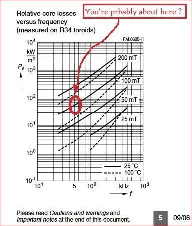

Does your core datasheet suggest an operating flux ? I couldn't find N87 curves.
old jim
EDIT found one
http://en.tdk.eu/blob/528882/download/4/pdf-n87.pdf
Log-log graph of relative core losses Pv in kW/m³ against frequency f in kHz for R34 toroids, with solid 25 °C and dashed 100 °C curves at 25, 50, 100 and 200 mT, and a red annotation circled near the 50 mT curve.
I will continue this after I get back as I have to go on a small trip today.
My parameters in short are 50khz , 160v primary with 11 turns , the duty cycle is rather large , almost to it's fullest which would be 50% if I'm correct , well that's about it , yes it's an N87 core made by EPCOS.
Unless I messed up somewhere, I get 40W to 50W in core losses, which would explain the temperature rise. This is based on Jims calculation of core area, the core diameter in the OP, and the graph of losses Jim posted. Please double check this, it's late & I'm tired.

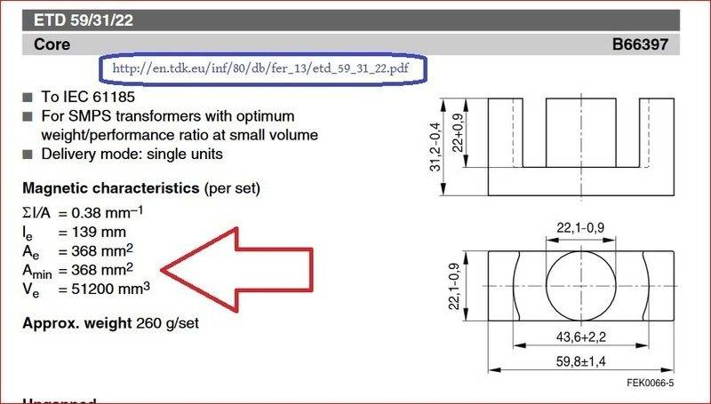

Datasheet excerpt for ETD 59/31/22 ferrite core, TDK B66397, with magnetic characteristics (per set) and dimensional drawings including side and top views with dimensions 31.2, 22.1 and 43.6 mm.
Well now
72.5 microwebers divided by 368 mm2 X 106 mm2 / m3 = 0.197Tesla ? 1970Gauss ?

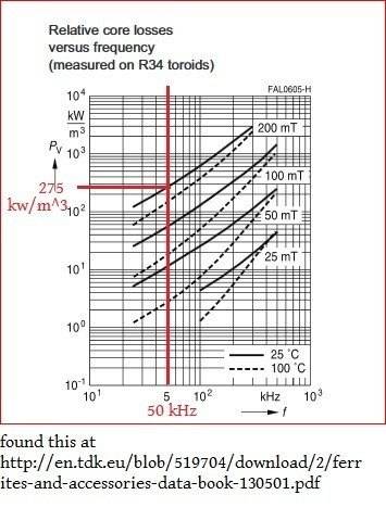

Which puts us on the ~200 milliTesla curve instead of where i drew the oval in earlier post
in fact let's use the TDK N87 curve i stumbled across just a couple minutes ago
it's from their 625 page catalog at http://en.tdk.eu/blob/519704/download/2/ferrites-and-accessories-data-book-130501.pdf , page 84
and there's tons of info there, download a copy for your e-library...
Log-log graph titled Relative core losses versus frequency, measured on R34 toroids: Pv in kW/m3 against f in kHz, with solid 25 C and dashed 100 C curves for 25, 50, 100 and 200 mT. A red line marks 50 kHz and a red callout reads 275 kW/m3.
maybe 275kw/m3 ?
275 kw/m3 X 51200 X10-9 m3 = 14 watts ?
Still seems a lot for such a small core.
You'd better check my arithmetic.
They say those curves are for sinewave and i don't know how to adjust them for square wave.
But this seems a reasonable approach for making an estimate. It's not like we're building a Steinway here .

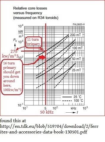

@Tom.G Does this look right ?
Annotated graph of relative core losses versus frequency for R34 toroids, with curves for 25, 50, 100 and 200 mT at 25 C and 100 C, red hand-drawn notes marking 11 and 16 turn primary estimates near 50 kHz.
@Salvador I don't know how difficult it is to add primary turns.
You've got me curious so i hope you try it.. Is this heat just from flux amplitude or something else ?

jim hardy said:
If it runs hot unloaded that's a clue because flux is proportional to volts per turn .
Volts PER turn.. as in ## \frac {volts}{turns}#### \frac {160}{11} = 14.5 ## volts per turn
## \frac {160}{16} = 10 ## volts per turn
so adding 5 turns will lower flux to ##\frac{10}{14.5} = 69##% of whatever it is now
and that semilog chart suggests losses will drop to more like ##\frac{100}{275} = 36##% of whatever it is now
i'd think you'll be able to feel that much difference.
Of course you'll have to add secondary turns to get output volts back up...

@Salvador
Post #3:
Salvador said:
core is then kept together by a adjustable metal squeezer
Post #9
Could the "squeezer" be acting as a shorted turn? Something is using a lot of energy if the Duty Cycle is at maximum.

Post 18 - i found the actual datasheet , i think, from TDK
It's Ve, 'effective magnetic volume of core' , just below point of red arrow, 51,200mm3
TDK datasheet for ETD 59/31/22 ferrite core B66397, with a red arrow pointing to the magnetic characteristics list and dimensional drawings of the core.
http://en.tdk.eu/inf/80/db/fer_13/etd_59_31_22.pdf page 2 of 9

I wonder Tom can you write down the math that you used to come up with these losses ?
Not anything that would be useful.:frown: I'm pretty sure I messed up the calcs in my post #16. Please disregard. I'm currently trying to match the @jim hardy calcs. To follow as soon as I can get them typed in.
Tom.G said:
Uhh, I think Duty Cycle is involved. See Eqs. (4) and (5) in the referenced article.

@jim hardy
I backtracked your steps and mostly agree. However our intermediate results differ in flux density by a factor of 100! I haven't carried my results further as it's a matter of 'just read the graph' from here on.
I feel like we are negotiating to find an acceptable compromise. Anyhow, here is what I've done this time. Please point out my errors.
I'm using the equation from http://wcmagnetics.com/wp-content/uploads/2015/02/appnote11.28.10.pdf, page 9, Equation 2.
B = [V x ton x 108] / [2 x Ae x N]
Where
B = peak AC flux density (gauss)
V = primary voltage (volts) . . . . . . . . . . . . . . . . . . . . . . 160V
ton = primary switch on time (seconds) . . . . 1-5 (10uS)
Ae = core area (cm2) . . . . . . . . . 368 3.68 cm2
N = number of primary turns . . . . . . . . . . . . . . . . . . . . 11
B= 160 x 1e-5 x 1e8 / (2 x 368 3.68 x 11)
= 160 x 1e3 / 8096 80.96
B= 19.76 1976 gauss
