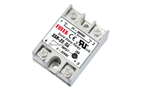

So I want to use this solid state relay, to fast switch an electromagnet.
About 2 times a second.
Weight: 112g
Size:5.9 x 4.5 x 2.3cm
Color : Grey
Fast switching
Reduced electromagnetic interference
Output voltage: AC 24-380V
Output current: 25A
Input voltage: DC 3-32V
Control Method: DC to AC
Mounting Method: Bolts fixed
These are characteristics of this SS relay.
From these characteristics, it says output should be AC. But my electromagnet is powered by DC, will it still work if i pass DC current through output of this relay?
What kind of power source are you using for the electromagnet??
lostcauses10x said:
what kind of power source are you using for the electromagnet??
30 v dc, I wrote it.
draw out your circuit
some solid state relays will switch dc, some will not
it depends what they used for a switch inside the device
some use a scr which won't turn off until next sinewave zero crossing, which for dc is never.
some use a device that can be gated off mid-cycle, like a power transistor inside a bridge rectifier, and that should interrupt DC.
so check the datasheet carefully perhaps there's a clue there.
i wonder what they meant by "fast switching"...
if you have it already try it out on a big light bulb, use one of those big 300 watt halogens so itll pull some current at 30volts.
if you're ordering it go back to the catalog and look for one that'll switch DC.
you may have to switch instead the ac that feeds your power supply
or resort to a power transistor
in either case since an electromagnet is inductive you probably ought to include a "flywheel diode" across its coil.

Well,
My uncle came today and told me this:
We need to design a circuit, that turns on the electromagnet, which pulls a piston of sort. When that piston is pulled, a spring gets tightened. After electromagnet goes off, that spring pulls that piston back in.
This pulling motion is creating pressure somewhere(didn't really get that part) that sprays a tint or something.
My uncles is a mechanic at a newspaper printshop, their engineer has been having problems with this circuit so he told me to try and build it.
I said well yea, its no big deal.
I had relay in my head, and some PIC controller. Program it, and set a varicap(or resistor even, possibilities of PIC are many) diode somewhere to control the rate of pulling/sec.
But then electromagnet self-induction crossed my mind.
Its all fine and dandy that my circuit will turn on and off as desired, but will my magnet do so too? But then you mentioned this flywheel diode, and immediately i realized what it does.
I will try some simulations in National Instruments, and see what will happen.
I understand what you were trying to say with this thyristors in SS relays. If they do switch with thyristors, then they won't go on dc.
A normal relay has slow response, yes?
Thank you - thyristor is the word i was searching for.
Industrial electromechanical relay like Westinghouse BF is surprising - it'll operate within one line cycle. But there is a finite life on the contacts and DC shortens it.
a 555 timer could generate the timing for you and its output could drive the gate of a power mosfet directly.
