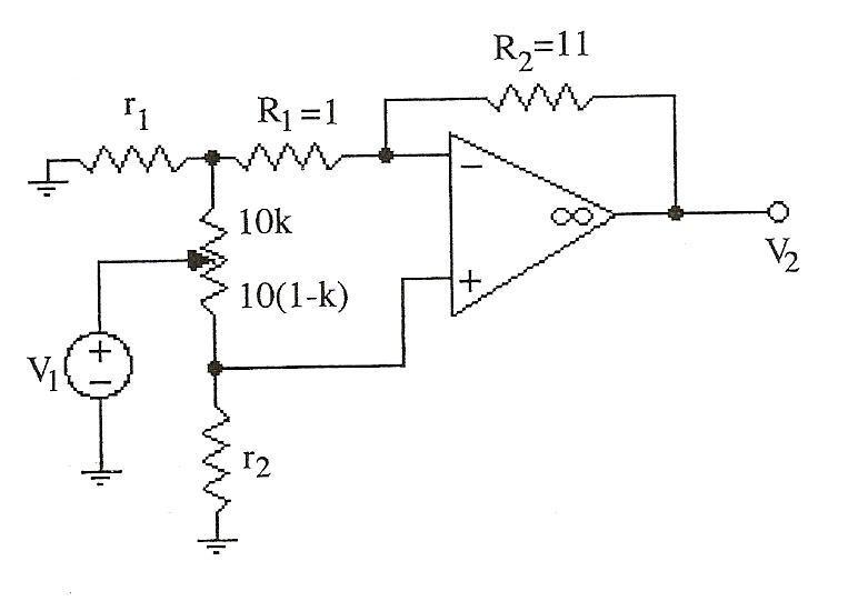

The op amp circuit shown bellow is intended to provide any gain between -10 (for k=0) and +10 (for k=1) by adjusting the potentiometer. Let R1 and R2 have the scaled values, show that..
V2/V1= {r1/(r1+10k)} [-11/{1+(10kr1/r1+10k)}] + [r2/r2+10(1-k)] [1+ {11/1+10kr1/r1+10k}]
i have no idea how to write nodal equations for a potentiometer. If anyone tell me how to do that, i can figure out the rest by myself. thanks
  • Op amp circuit schematic with a potentiometer: r1 and R1=1 feed the inverting input, R2=11 is the feedback resistor to output V2, and the potentiometer (10k above, 10(1-k) below) is driven by source V1 with its wiper tapping the non-inverting input, which connects to r2 to ground.
Think of the potentiometer as 2 resistors in series with values 10k and 10(1-k). That's all.
