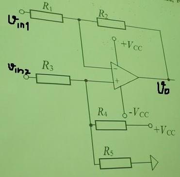

Here is my task:
Find output voltage Vo if Vin1=3V, Vin2=-2V, R1=R2=R3=100KΩ, R4=300KΩ, R5=150KΩ, VCC=15V.
Circuit schematic of an op-amp with inputs Vin1 through R1 and Vin2 through R3, feedback resistor R2, and R4 and R5 on the non-inverting node, with +VCC and -VCC supply connections and output Vo.

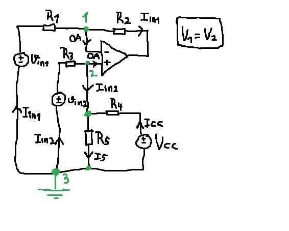

Hand-drawn circuit schematic of an op-amp with resistors R1, R2, R3, R4, R5, voltage sources Vin1, Vin2 and Vcc, and node labels 1, 2 and 3 with currents Iin1, Iin2, Icc and I5 marked.
Applying KCL at node 2 we get:
$$-Iin2+I5-Icc=0$$
$$-\frac{V3-V2+Vin2}{R3}+\frac{V2-V3}{R5}-\frac{V3-V2+Vcc}{R4}=0$$
$$-\frac{Vin2-V2}{R3}+\frac{V2}{R5}-\frac{Vcc-V2}{R4}=0$$
$$V1=V2=\frac{Vin2/R3+Vcc/R4}{1/R3+1/R5+1/R4}=1.5V$$

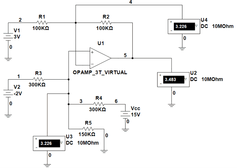

But Multisim give me different voltage V2:
Multisim schematic of an op-amp circuit with V1 = 3V through R1 and V2 = -2V through R3 into the inverting input, R2 feedback, R4 to a 15V Vcc, R5 to ground, and four voltmeters reading 3.226, 3.483, 3.226 and 3.226 V.
As you can see, Multisim measure 3.226V.

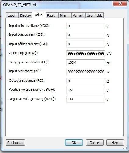

Here is OPAMP setup (since it's ideal, I put some huge numbers for A and input resistance, output resistance is 0):
Properties dialog for an OPAMP_3T_VIRTUAL op-amp model, Value tab, showing offset voltage and current set to 0, open loop gain and input resistance set to very large values, output resistance 0, unity-gain bandwidth 100M Hz, and voltage swings of +15 V and -15 V.
Any idea what's wrong?
In your Multisim circuit you have set R3 to 300k, but the problem statement says it is 100k.
etf said:
I can't figure out how I didn't see it :) Thanks!
Sometimes a fresh pair of eyes on the problem can pick out the things you miss repeatedly due to familiarity!
You might want to take note that in your simulation the "voltmeters" have an impedance of 10MΩ, and will influence the circuit behavior to some extent (it'll show up in the second or third digit of the values I'm guessing). So don't be surprised if your calculated values are almost but not quite the same as your "measured" ones!
