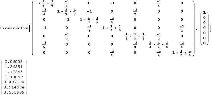

So I need to find the total voltage across the current source.
Looking at the attachment, I took

So I notice this as 8 equations with 8 unknowns. However, when I plug this into matlab,
I get (Warning: Matrix is close to singular or badly scaled.)
Is there a problem with my equations?
Any help would be appreciated.
Node A is the reference node (ground). You don't need to solve for the voltage at that node, so you should eliminate that node from your equations. If you solve for 7 unknowns with 7 equations you shouldn't get that error message.

It's easy to make a mistake entering all the coefficients in a problem like this. The first thing you should do is make sure that the transpose of your coefficient matrix is the same as the matrix itself.
If you could paste the matrix from Matlab into a post here, I could check it out.

You must arrange the matrix so that the elements containing the driving point admittances (such as g3+g1+g6) are all on the main diagonal. If you don't do this, then the columns and rows don't apply to your node variables in the same order.

I think you've got it correct except for one little problem.
I think it should be:
a=[g3+g1+g6, -g3, 0, -g1, 0, -g6, 0;
-g3,g5+g4+g3,-g4,0,-g5,0,0;
0,-g4,g8+g4+g2,-g2,0,0,0;
-g1,0,-g2,g1+g7+g2,0,0,-g7;
0,-g5,0,0,g5+g10+g11,-g10,0;
-g6,0,0,0,-g10,g9+g10+g6,-g9;
0,0,0,-g7,0,-g9,g12+g9+g7]
This shows that if you arrange your matrix so that the driving point admittances are on the main diagonal, the matrix will be equal to its transpose (for networks of linear, passive components). Checking that would have revealed your last little error.
Try that and see what you get.
I think you've got the method ok; you're just having problems with the details (as I did when trying to rearrange your matrix).
See the attached image for my solution. I multiplied everything by 1000 to make the matrix more compact. If you still don't get what I get, compare yours to the attached image.

yep I got
Vh = 2.0601
Vg = 1.2625
Vf = 1.1724
Ve = 1.4885
Vd = 0.5560
Vc = .91499
Vb = .49719
ya nice catch on that little mistake there. thanks a lot.
