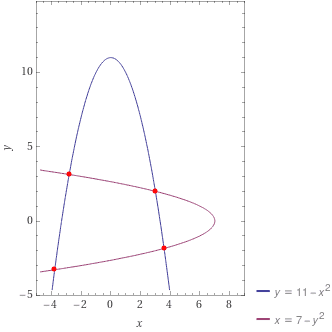

I made wolfram draw graphs of y=11-x^2 and x=7-y^2 where ##\sqrt{x},\sqrt{y}## in the problem statement is transferred to x, y.
I could confirm that there is only one solution for x,y>0, obvious x=3, y=2.
Equation for x is
[tex](11-x^2)^2=7-x[/tex]
[tex]x^4-22x^2+x+114=0[/tex]
[tex](x-3)(x^3+3x^2-13x-38)=0[/tex]
