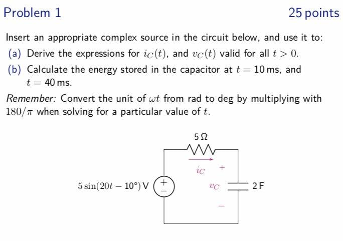

An image of the problem is attached. I need to solve for ic(t) and vc(t) by adding a complex source.
I don’t know where to start here. I don’t understand the question, and I can’t find the information I need in my notes. Can somebody explain what ic(t) and vc(t) are and what it means to add a complex source?

##i_c(t)## is the circuit current in the time domain. ##v_c(t)## is the potential across the capacitor in the time domain.
To solve the problem in the easiest way you'll want to work in the frequency domain, i.e., with phasors. So you need to examine the expression that defines the voltage source and create a phasor (complex) representation of it. Convert the capacitance to its complex impedance. Analyze the circuit.
Once you have solutions in the frequency domain you can convert them to the time domain to answer parts (a) and (b).

I found the impedance of the capacitor to be .025j. I found the voltage to be 4.924-.868j. I then divided voltage by total resistance, and converted back to the time domain to get 5sin(20t+9.707deg) for ic(t).
Does this look correct so far?
Capacitors always have a negative impedance. Try again with ##Z_C = -j0.025\; \Omega##.

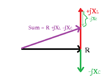

I was taught when starting out with complex arithmetic to always make a sketch
actually two or three sketches
one for the voltages, one for the impedances, and one for the currents.
e.g.
Phasor diagram with a black horizontal arrow labelled R, a red upward arrow labelled +jX_L, a green downward arrow labelled -jX_C, and a purple diagonal arrow labelled Sum = R + jX_L - jX_C.
helps keep one's thinking straight
of course that was in the days of slide rules when it was vital to think one step at a time...
old jim
